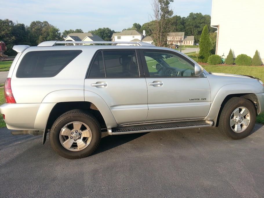

i picked up a 2003 4runner about 3 months ago with about 80k on it for $13800, while driving to mall this just stood out and i bought it because it was in such a good shape. i always wanted a 4runner especially this body style ever since i was in college and it was about the time it came out.
I have had always had toyotas sister -lexus cars but since family is growing wanted a daily driver so not to put many miles on the lx470.
This car was bought from a dealership and the owner who owned it was still there. so i got little history of it. Always beem maintained by him/ brakes/fluids/battery/new tires and pretty much done on time and it showed. i am somewhat handy myself so i added a nice navigation/back up camera.
