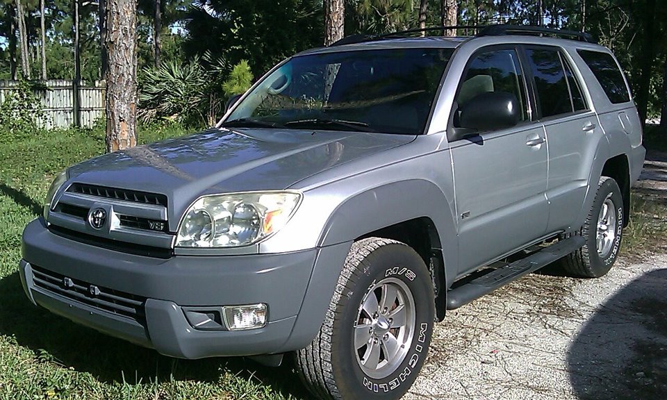

Here's a pic of mine with painted cladding. It's not color-keyed (the sun makes it look like the door trim is), it's just been repainted to the original satin grey. It seems pretty durable and I doubt anything expensive was used. Toyota has a TSB on painting plastic and it mentions cleaning the plastic and roughing it up as being essential to gettting good paint adhesion.
