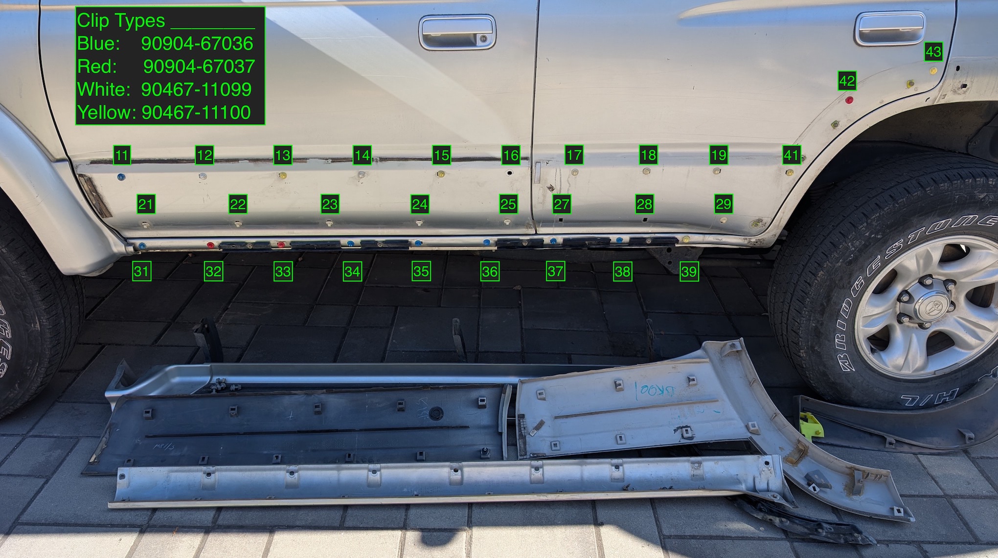

I need to R&R the exterior trim on my T4R-Ltd. Looong ago, there was some crappy body work done. A couple clips are missing, and I don't have confidence the ones there are correct. Maybe they are, but I dunno. Does anyone know the correct clips (color coded) for the locations?
I know 16 is a metal screw post. 27 and 28 are missing. I assume they are white 90467-11099? The others are in question.

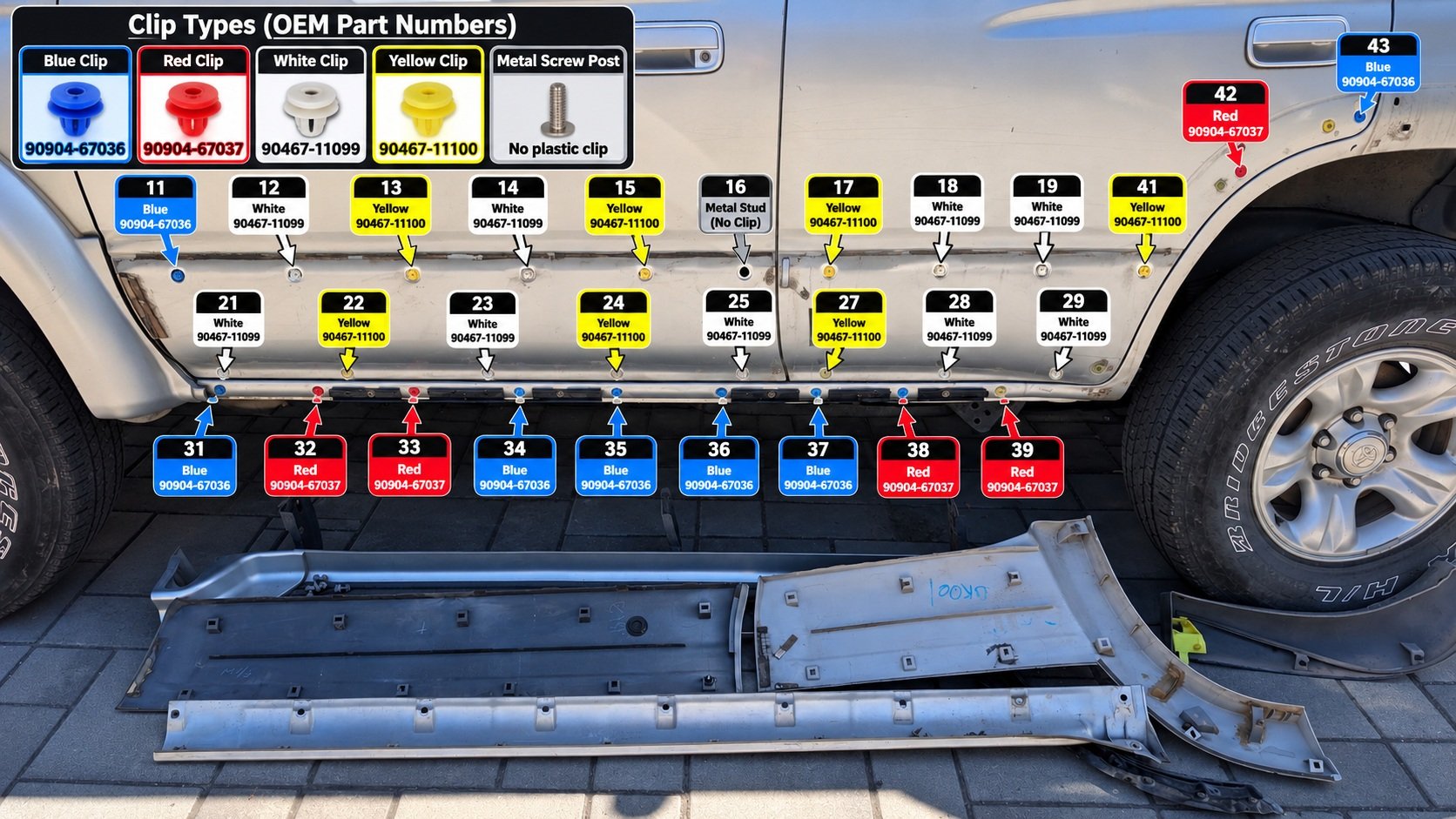

According to our AI overlords....use this info at your own risk:
PositionCorrect fastener
1190904-67036 — Blue
1290467-11099 — White
1390467-11100 — Yellow
1490467-11099 — White
1590467-11100 — Yellow
16Screw/stud — not a plastic clip
1790467-11100 — Yellow
1890467-11099 — White
1990467-11099 — White
2190467-11099 — White
2290467-11100 — Yellow
2390467-11099 — White
2490467-11100 — Yellow
2590467-11099 — White
2790467-11100 — Yellow
2890467-11099 — White
2990467-11099 — White
3190904-67036 — Blue
3290904-67037 — Red
3390904-67037 — Red
3490904-67036 — Blue
3590904-67036 — Blue
3690904-67036 — Blue
3790904-67036 — Blue
3890904-67037 — Red
3990904-67037 — Red
4190467-11100 — Yellow
4290904-67037 — Red
4390904-67036 — Blue

JustTroltln, that is very cool.
I asked Chat, but it was a text prompt and not quite as clear as my post here. It came back with questionable results.
I did not think of submitting my photo and annotations. Thanks for that!!
Following your lead, I may submit to a couple other engines for confirmation. AI is getting pretty awesome!
