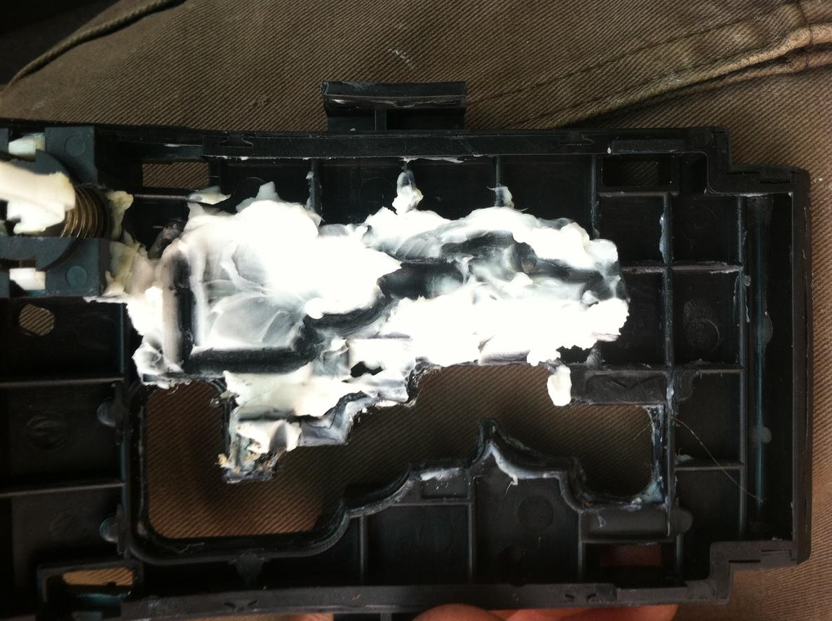

So, opened it up and found the pin! It has come out of the slot with a small spring thats inside. The spring is still in the slot but I cant get the pin to hold in. Once i put the car into gear it wants to pop out and the shifter is floppy again.

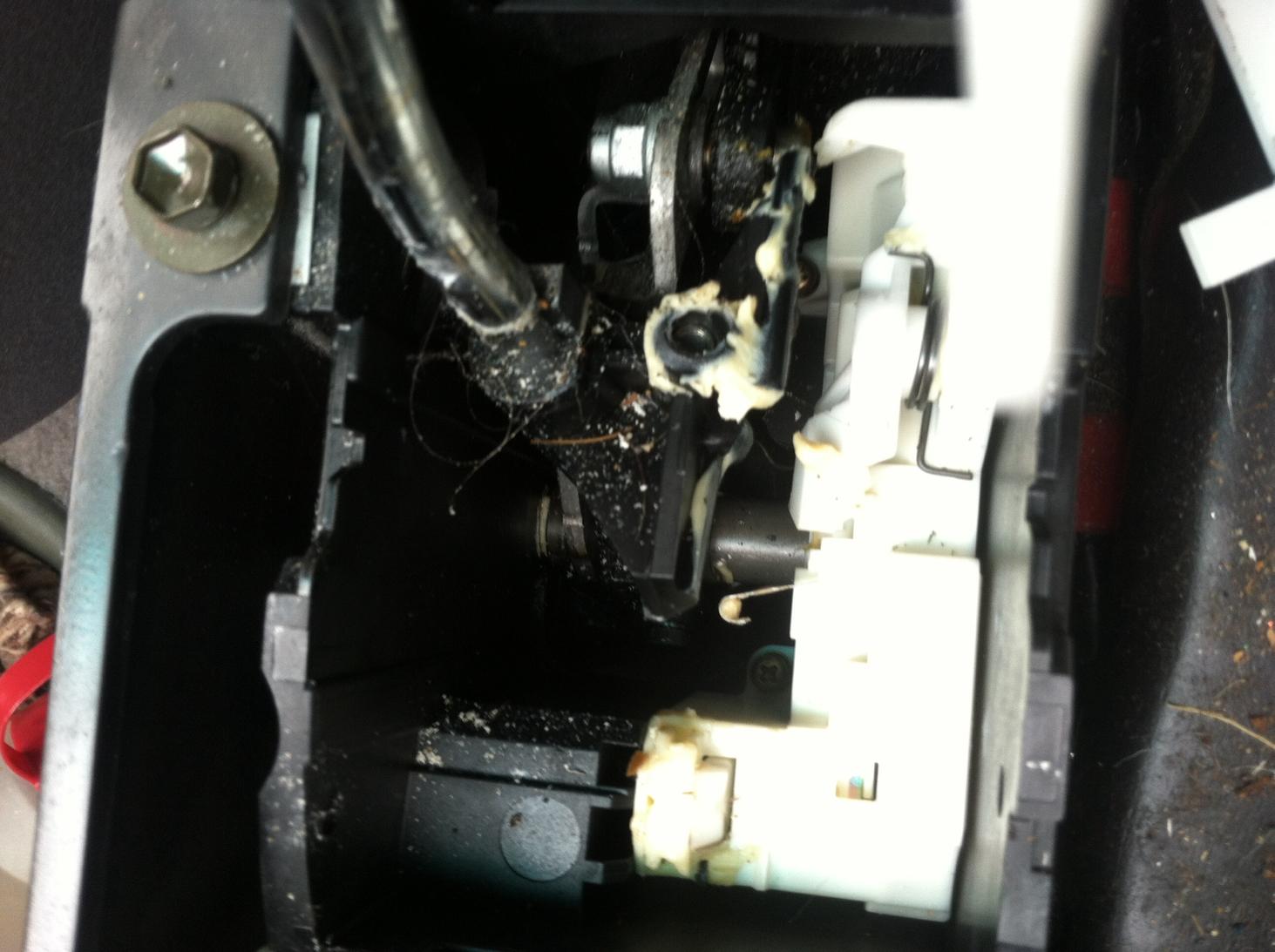

This is where the pin needs to go but it wont set well in the slot with that spring. Would like to see a diagram if anyone has one to see how it locks in place.

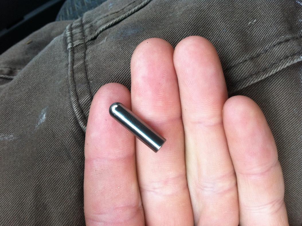

One side of the pin is flat and smooth, the other end which i believe runs the track is rounded and smooth. Nothing looks broken or in rough shape. The link thread posted earlier mentioned something about the spring being too long or stiff. They mentioned cutting it to fit down in the slot better.
Its fixed! I put some crisco on the track to see where the pin was slipping out. Never found any faults, but was still having trouble shifting. I go the pin spring out and cut it about 1/8" and it works awesome. Better than factory! Always had trouble going from 3-2-1, no problems now.
