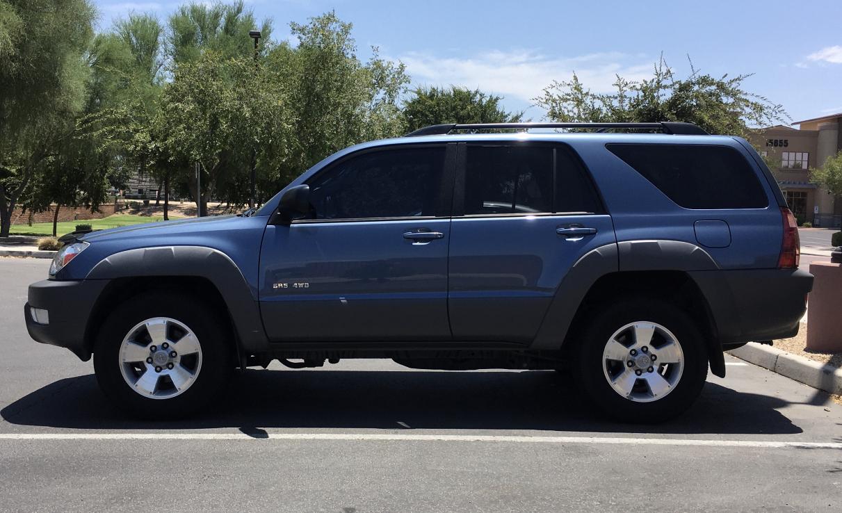

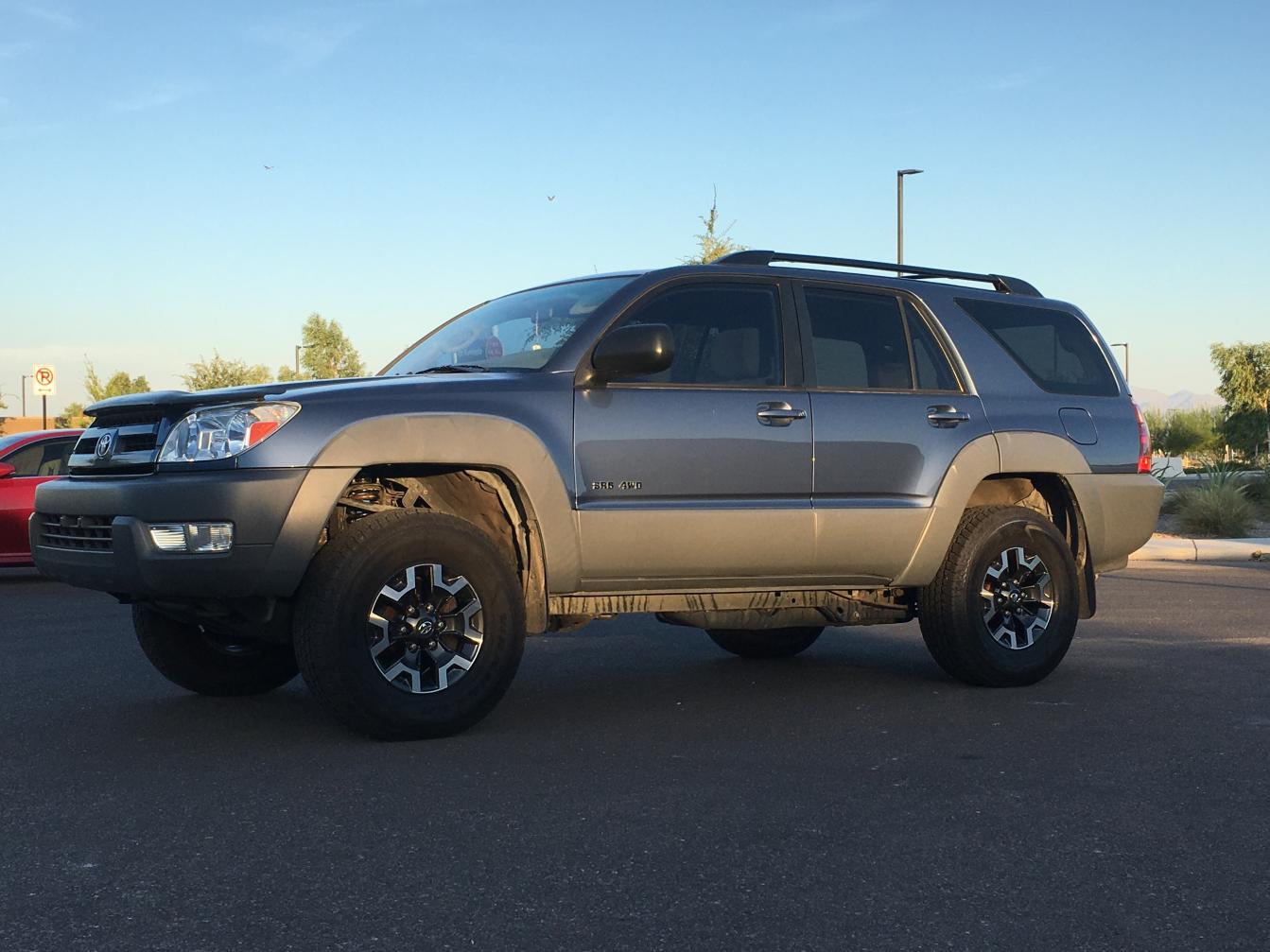

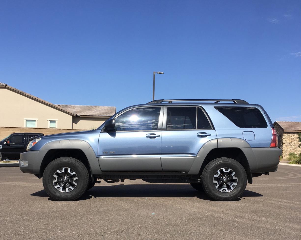

Already picked up the suspension, paid $100 delivered to me. The suspension has less than 200 miles on it, pretty much brand new! Installed it yesterday, took about 1.5 hrs simple job. Lifted the front right around 2.25”, not sure what I am going to do about the rear?
Wheels and tires should be here today or tomorrow.
Before and after.

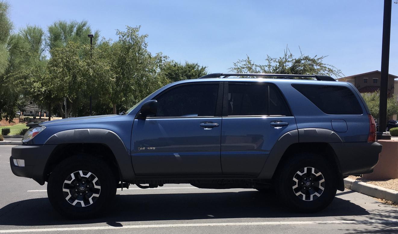

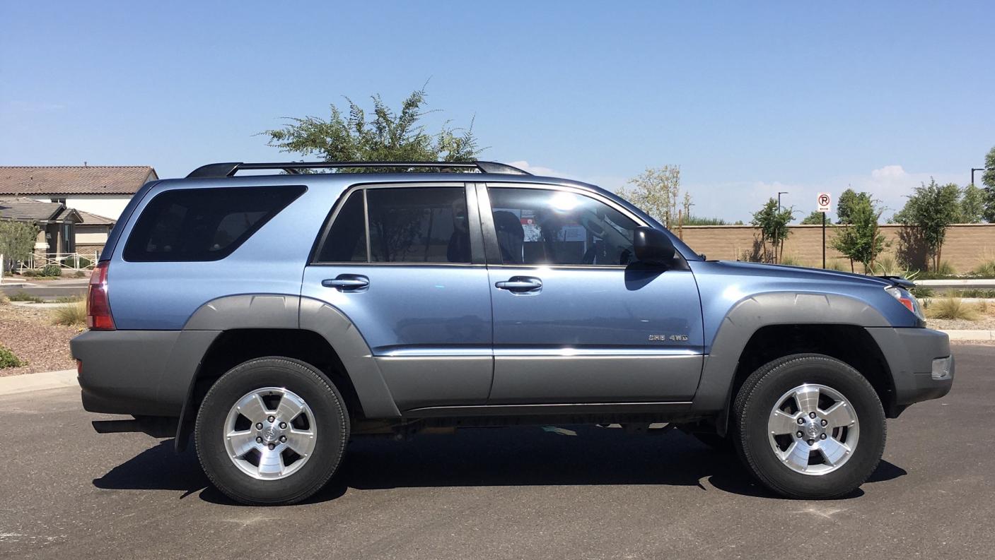

4wheelparts screwed me over on my wheels and tires, so I picked up a set of like new 2020 TRD Offroad wheels & tires with less than 300 miles on them, paid $600!! I am pretty happy with the look. Will post better pics tomorrow.

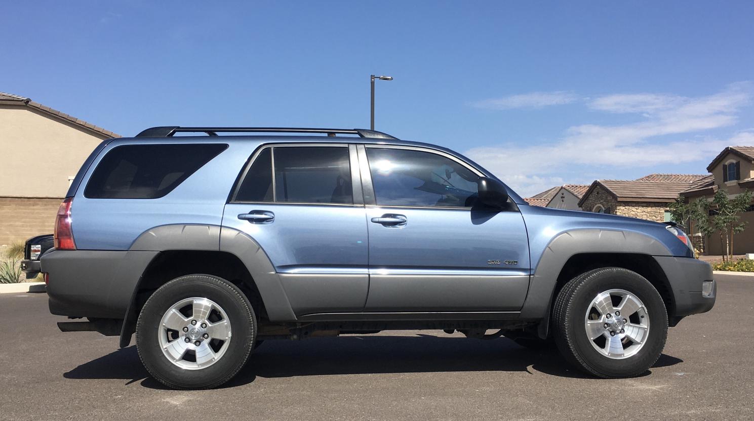

Some more before and after pics. Hopefully picking up a coil spacer for the rear Saturday.

Great find, a 2003 with only 80k miles! You got a great deal on the 4R, and the susp. and wheels/tires.
Did you buy just the TRD front suspension? The front looks higher than the rear.
I looked at those Tacoma wheels, but bought something different. They look good on a 4Runner!
I got the entire TRD Offroad suspension, but only installed the front. It’s about 1” higher in the front. I am going to install 1.5” spacers in the rear. Should be the perfect height once I build out my rear drawer system.

Got the rear lift done this morning, 1.5” daystar spacer.Drove it around a little this morning and settled a little bit more than the photo.

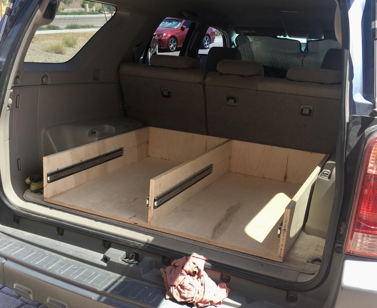

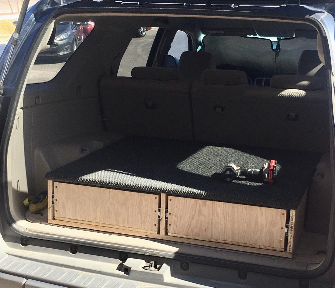

Started on the rear platform and drawers today, made some good progress just need to make the face of the drawers. Not sure what word I am going to use yet, definitely want something that will look pretty nice when stained.
When the drawers are extended it will double as a table also.

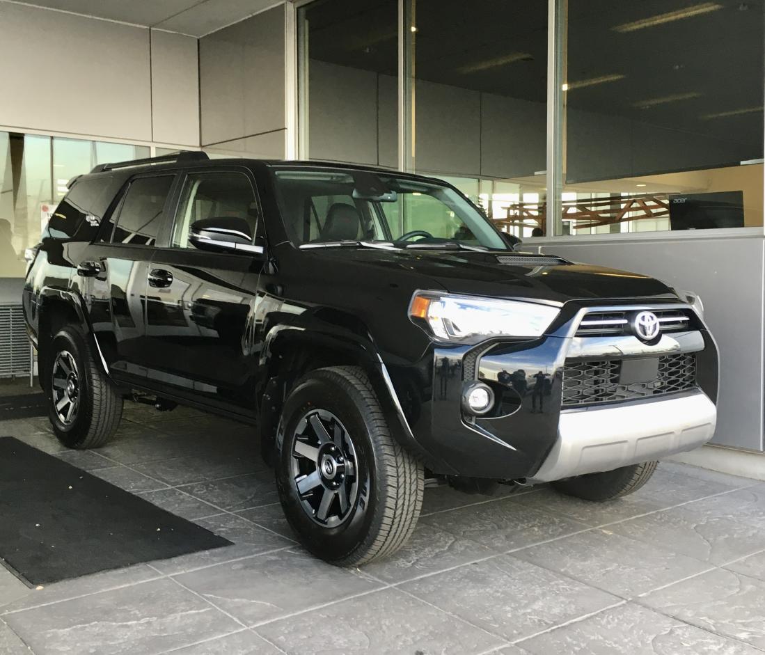

Bought the wife a new 21 4Runner TRD Offroad premium tonight! Black TRD Pro wheels & Falken AT3 tires will be installed next week!

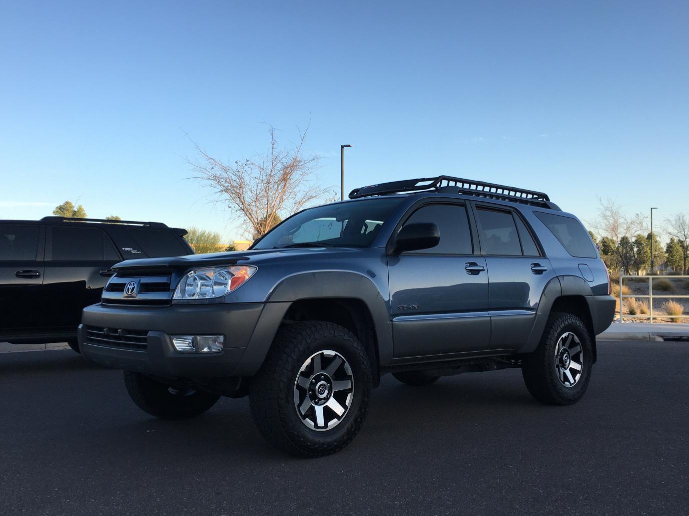

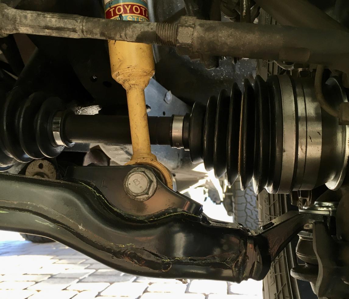

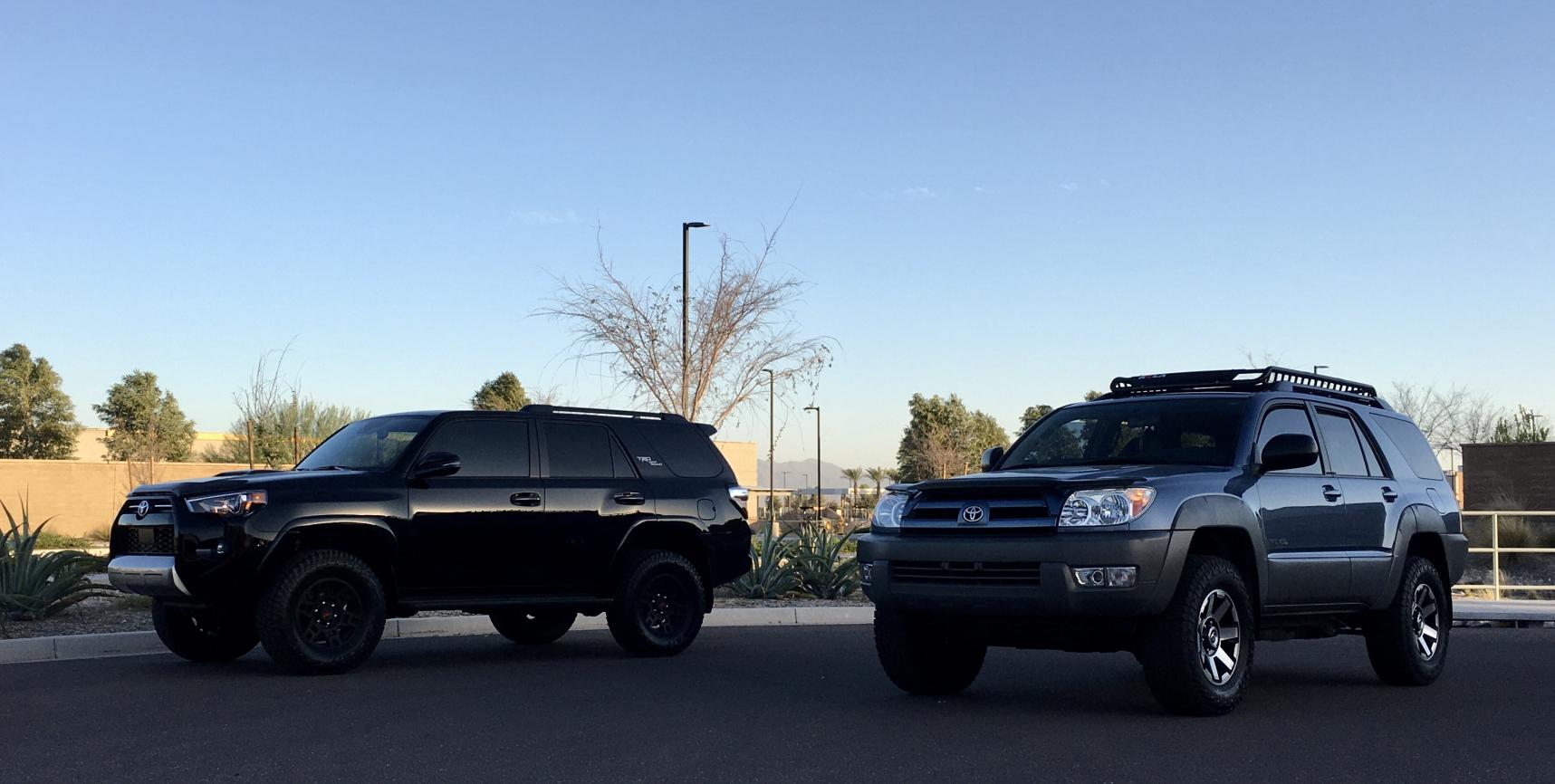

Got a few things done the last two days, installed new roof rack, lean kit, new OEM lower control arms and a new CV axle on the driver side.

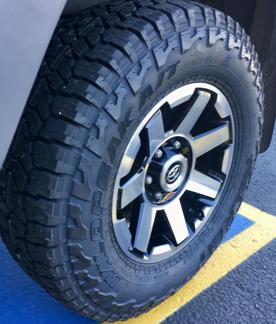

Forgot to post the new wheels and tires also! We got the wife’s 21 lifted and installed TRD pro wheels on it. So I took her old wheels and added new tires 275/70/17 Falken AT3.
