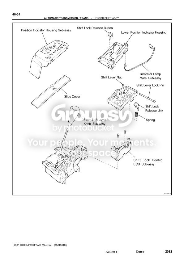

I think the exact part i need is the "Shift Lock Control / ECU Sub-Assembly" from the diagram below.
747, you probably need the same, if you're under warranty you should get them to fix it. I haven't removed the part to see if it's actually repairable but the guy told me it's sealed and there's nothing you can do to it except to change it out.
i might try to figure out if that's the case this weekend.
thanks in advance!
EDIT: Diagram ABOVE, in the post by morbius

:mad: I took the floor shift assembly apart today... or atleast half way. It doesnt seem to be a problem with the shift lock ECU assy. I'm focusing on either the "lower position indicator housing" or the unnamed hunk of plastic that the "shift lever lock pin" goes through. :redbrick:
