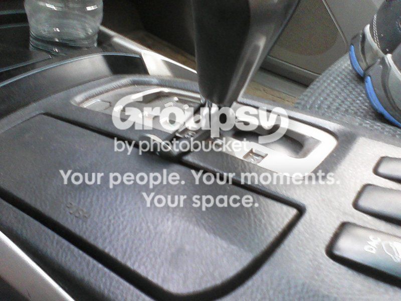

For the past couple of years I have used a black elastic band with a fender washer. Run the elastic through the washer and tie it tight enough to just slip over the gear shifter. Put the shifter into drive and stick the washer into the edge of the little compartment door that's in the shift console.
This holds the shifter over into 4th gear. The elastic is flexible and will allow you to put it in a few different gears. If moving more than a couple gears, pop the washer out of the door edge.

... Put the shifter into drive and stick the washer into the edge of the little compartment door that's in the shift console.
This holds the shifter over into 4th gear...
Trying to visualize this. Can you take some pics?
Thanks.
Pix worth at least 100 words . . .
0814131822_zps88eea476.jpg~original
When towing they recommend keeping it in 4th and not drive, as the transmission will hunt too much.
I understand but what I meant was:
Others in the thread were saying the shifter is side-to-side floppy in and out of D. You are keeping it in 4th for a reason. Do you have trouble keeping it in D (to the right) and not randomly going into 4th when not towing?

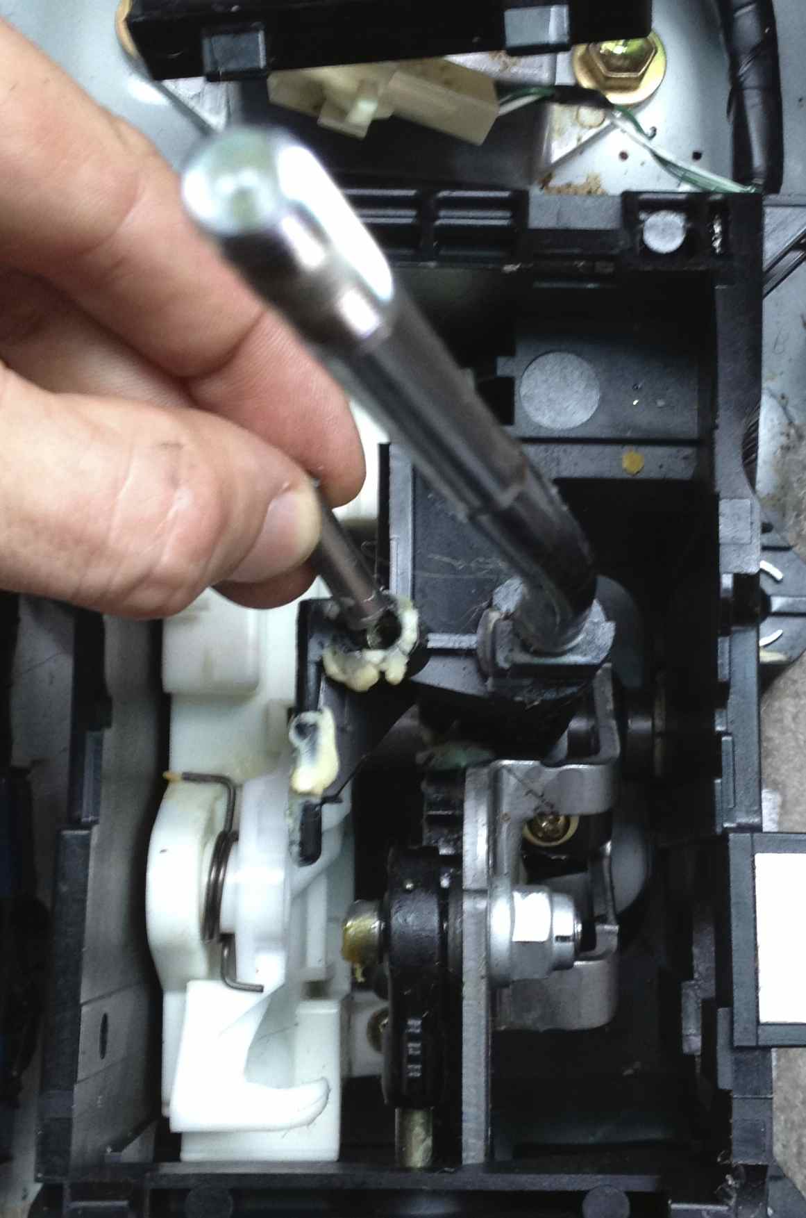

I haven't fixed mine, but the plastic holder is the little black object in which I'm holding the pin that rides in the selector track. The bottom of the pin has a spring, and that black plastic is the tube in which the metal pin rides. Seems that a small machined holder that could be properly clamped would solve our common issue. Someday, I'll get around to it.

Yes, a 3D printer could most likely fix this problem. I'm going to strip it down even further this weekend to have a better look at it. As far as prevention, pro-active lubrication may very well be the answer. I'm anxious to have a look at the underside of the shifter box top plate. In order to remove the top plate, you have to remove a 4" pin at the rear of the black shifter box, held in place by a small push nut. I hope new push nuts of that size (quite small...about 5mm) are easy to find!
