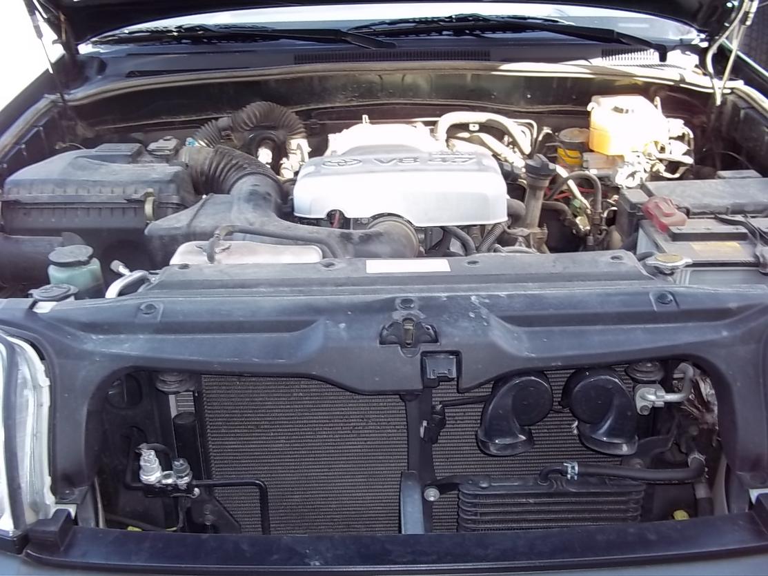

Can anyone simply tell me whether or not the cooler in front of the radiator in this picture is the tranny cooler?

That's the one you're looking for in the picture. Wish it came on the V6 also. At least it is pretty cheap and easy to install as aftermarket.
stacked plate fluid cooler=transmission cooler?
Excuse my ignorance...
:withstupid:
In this instance, Toyota is using it as a transmission fluid cooler. But, in other applications, the same type of device could also be used to cool other automotive fluids, like power steering fluid and engine oil, if nececssary.
