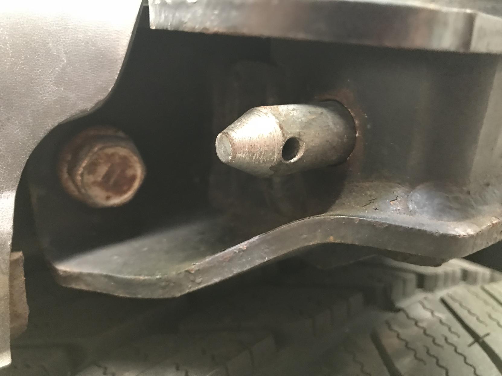

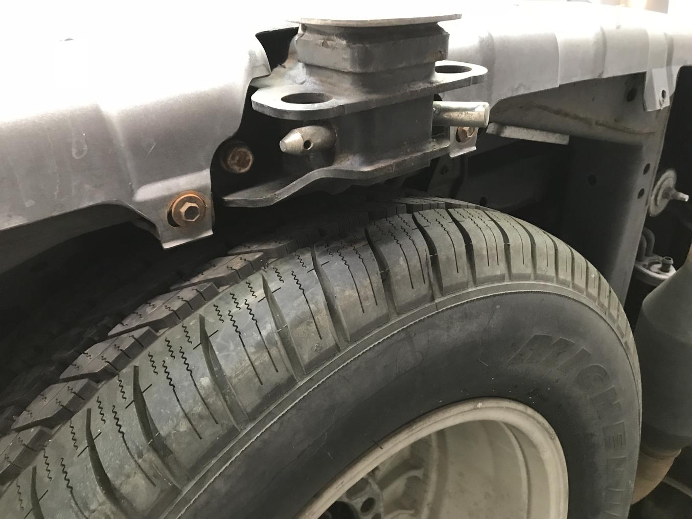

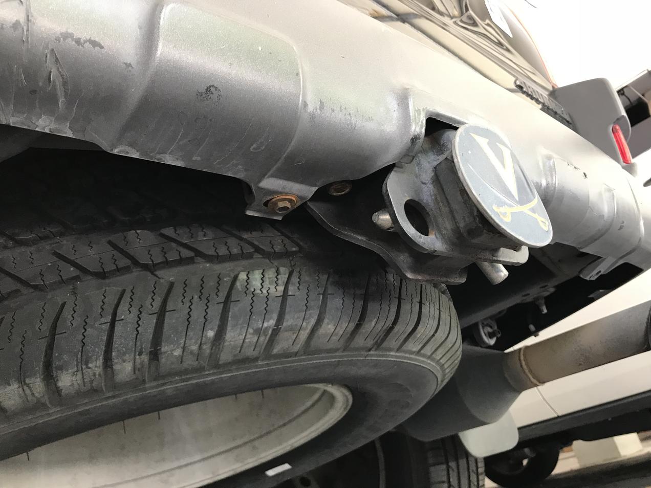

I assume this is the lower rated 5000lb. Rated hitch. My 2003 is one of the plastic clad versions and must be one of the earlier versions. I want to tow my bay boat and with trailer etc. that would be pushing the limit. Can anyone recommend an aftermarket upgrade? Would you get one from Uhaul or would it be better to order one from trailer and have it installed? If so could someone give me the link to the right model?. I have towed the boat with the old hitch and had no problems but will be making a 5 hour drive on flat rural highways to vacation in SW Fla from GA . My trailer is a high end newer trailer with dual axels and doc brakes. I would rather not have to get a new vehicle.

Your hitch is what is termed the "V6 Hitch" and is mounted only to a rear cross member the rating is #5000, the "V8 Hitch" is more robust
since it is attached to the main frame and not a cross member it's rated at #7000 (4WD) to #7300 (2WD) BUT only when using a
WDH (weight distributing hitch) otherwise it's only rated at #5000, even though both hitches are rated at #5000 the V6 hitch CANNOT be
rated more by using a WDH because Toyota says it isn't safe to do so with the V6 hitch as it can't effectively transfer the additonal weight
to the vehicle's frame via the rear cross member which is what the WDH does.
Just an FYI if you're not aware a WDH is not the hitch attached to your vehicle but an attachment added on the tongue of the tralier which
then hooks up to your hitch, what it does is tranfers some of the weight of the trailer to the front of the vehicle through the frame, which also
helps level out your vehicle for safer towing of a heavier load/trailer.
If you buy an after market hitch, I would say either Reese, Curt or Draw-Tite brands and at least a class 3, which are usually rated for #6000
and #600 tongue weight, if your boat and trailer weight more than that go with class 4 if you can find one for a 2003 4Runner.

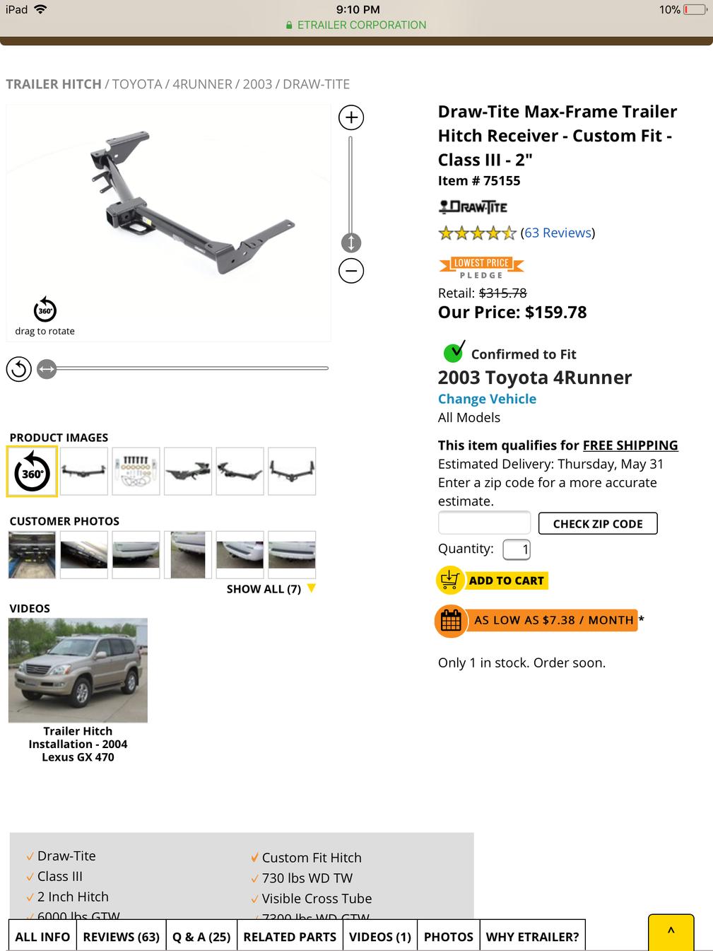

I also included hitch I was considering.

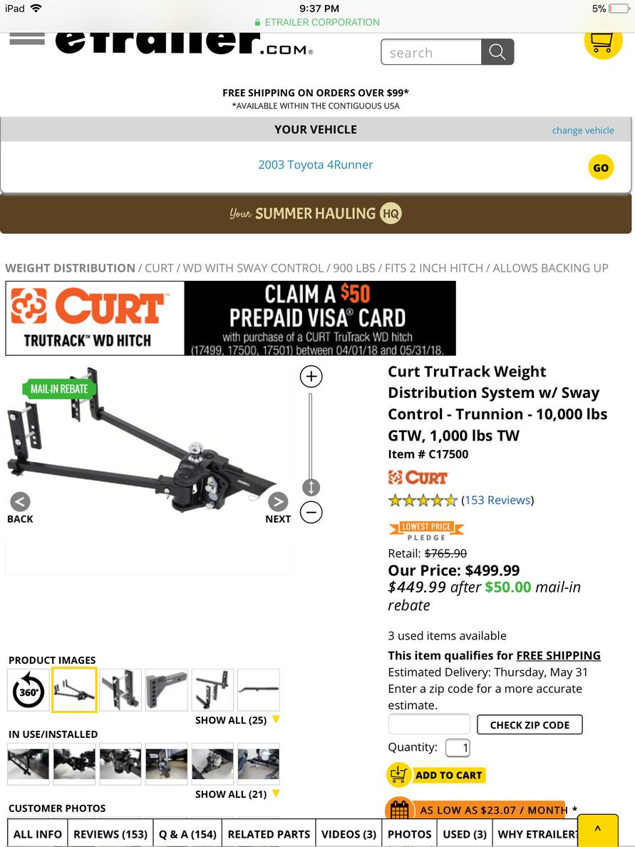

upgrade to class 3, but do you think I need to lay out another $500 for an additional 1000lbs rating? I am all about safety but the WDH (is this
it in following pics
?) looks complicated and cumbersome and potentially dangerous if I screw it up. If it makes the trailering experience safer and less stressful it
is worth it to me however.
That class 3 hitch should work just fine, and yes that's a WDH, I would wait and see how she tows with the new hitch, if you need to add the
WDH you can do so enroute if you feel you need it, it will make towing a lot better and safer experience if you're up around #5000 and especially
if it's more weight, what you will most likely encounter the most is the rear of your T4R sagging more than it should for safe towing because it
takes weight off the front of the vehicle which causes the alignment to be off causing steering and braking issues, this can also be countered
by adding air bags in your rear springs to raise the rear back up and level the vehicle which is much cheaper than a WDH and also you can still
add the WDH if you feel you may
still need it, if you do get the WHD get it from experienced trailer/towing supplier and also have them help you install it and especially show
you how to properly set it up, if installed and especially setup incorrectly it could be worst than not having the WDH at all or at the very least
no better.
Do you have the additional transmission cooler, If not, it would be good insurance to install one to avoid over heating your tranmission which
could do major damage to it, it gets awful hot in Florida this time of year?

I’ve read that WDH are not for boat trailers. I don’t know why but likely because of but low tongue weight of boat trailers.

The reason why they don't recommend WDH on boat trailers is due to most of the boat trailers have surge brakes
