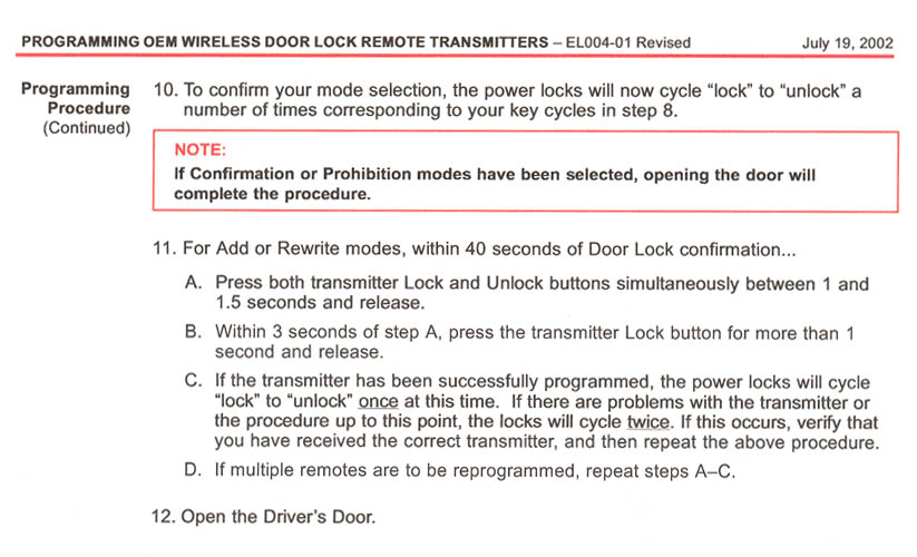

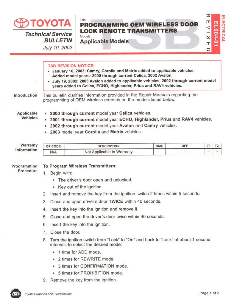

Programming Wireless Door openers
Here is the TSB from the 2007 4Runner manual. I haven't tried to use it but it is supposed to cover all 4th Gen models.
