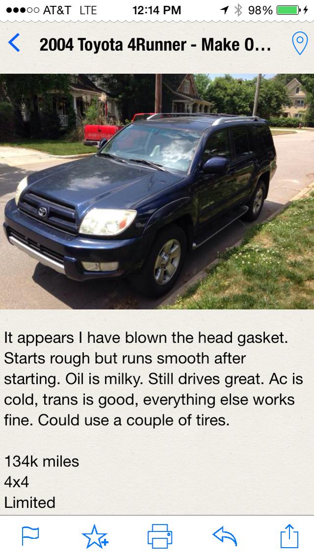

even saw this listing today, see pic. Craigslist Raleigh, NC.
