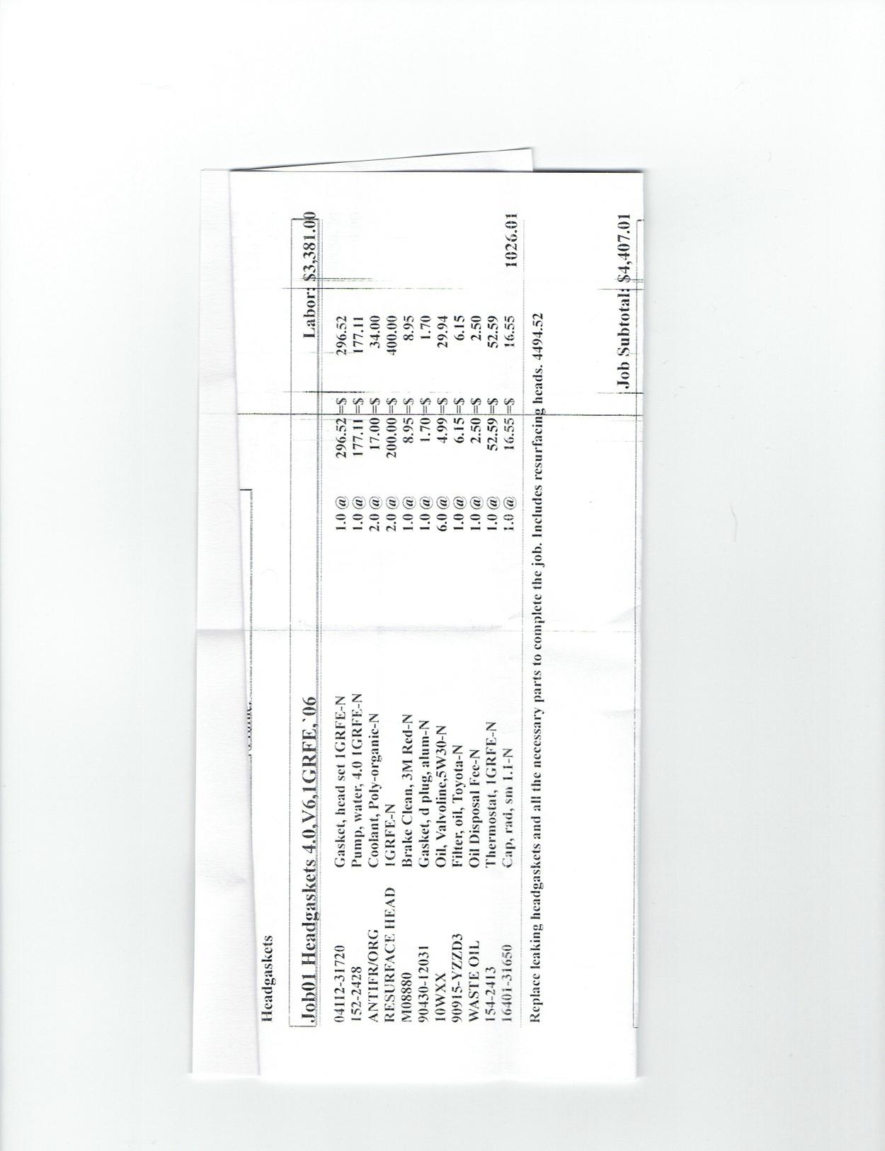

Just got the 4Runner back from the shop yesterday. A whopping $4.5k. Ugh. Attached is the invoice. Runs great now though.
