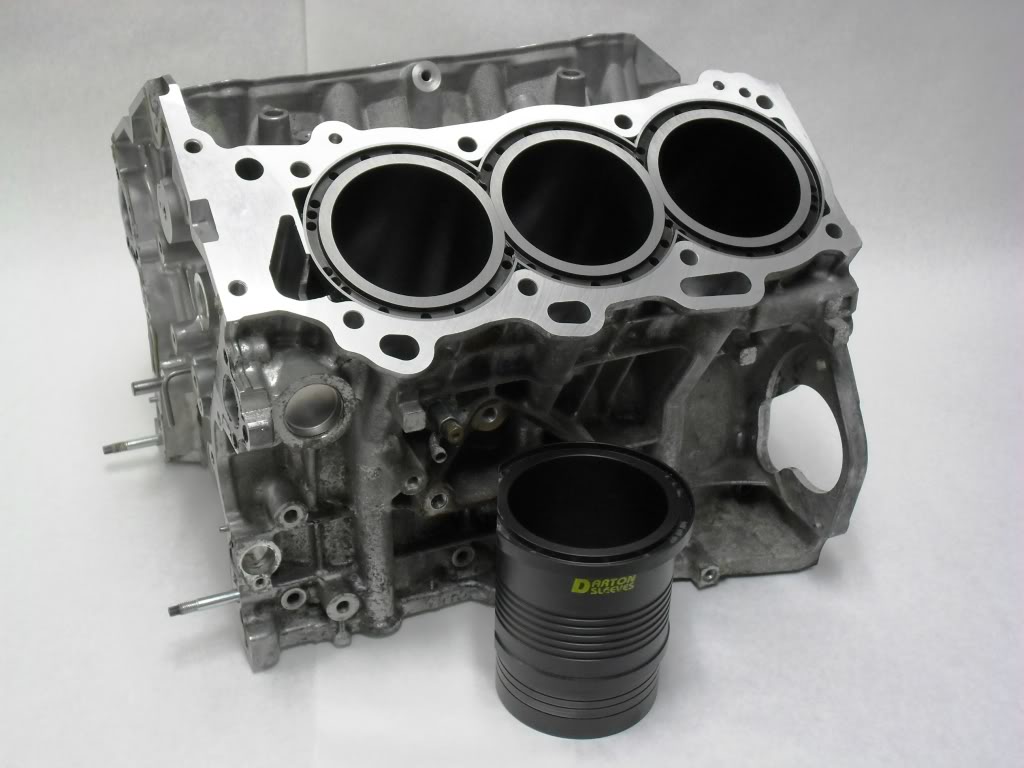

There are a few good solutions out there already for the 1gr, but they aim for the performance side of things and can get really expensive. 1st there is a cometic head gasket and with the combination of ARP head studs. The other option is closing the deck. Darton sleeves act as a closed deck but have passages that allow coolant to flow so there are no hot spots. I'll be doing this later down the road.
Just FYI: anyone looking for head studs for a 1GR/2GR should know they are the same exact studs as the Chevy LS1. We just rebuilt a 2GR with them and it worked perfect.
