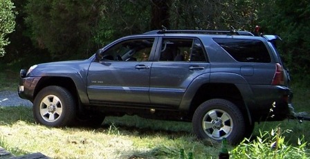

Alpin - if you live in the south east you can check out my 04 for sale. It's listed in the classified section.
