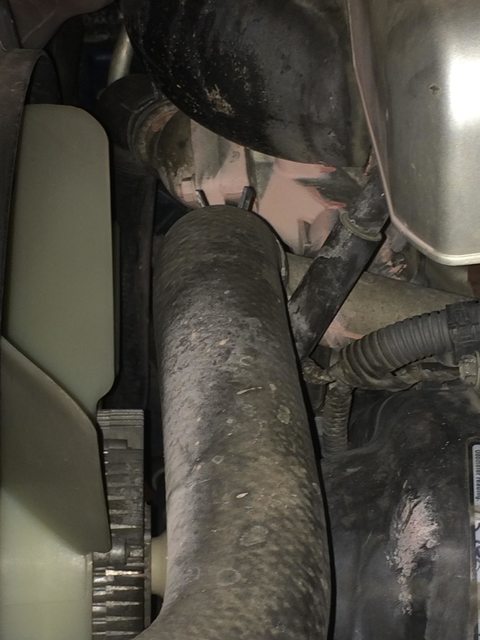

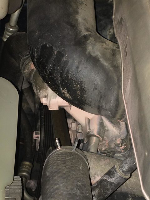

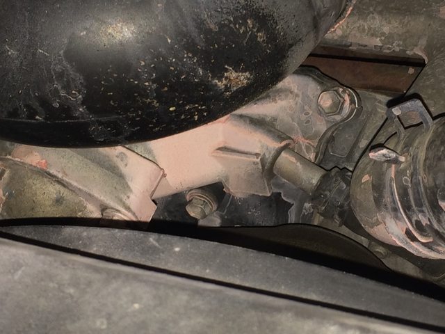

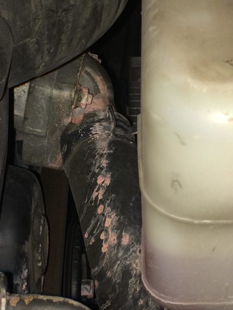

I'm thinking leak might be coming from here where the highest concentration of pink residue lies. Not sure, but H20 pump gasket??? Or???

Bottom right pic looks like it's where your rad hose attaches to the thermostat housing, or the thermostat housing to water pump. That one can be tricky with form in place gasket, sometimes they sell a paper gasket for it to but it sucks. It's kind of hard to tell with coolant everywhere, you might want to clean it all up and try looking in a shorter amount of time or look for wet coolant only at that leak rate, not the dried residue.

Clean all the dried coolant off really well and then run the engine for a little while at idle so the fan doesn't cause the coolant to travel so far. You should be able to spot the leak pretty quickly. FYI I have seen coolant hoses leak from the white cords that are molded in to them... The hose cracks internally and then coolant travels up thru the cord and out the cut end of the hose.
