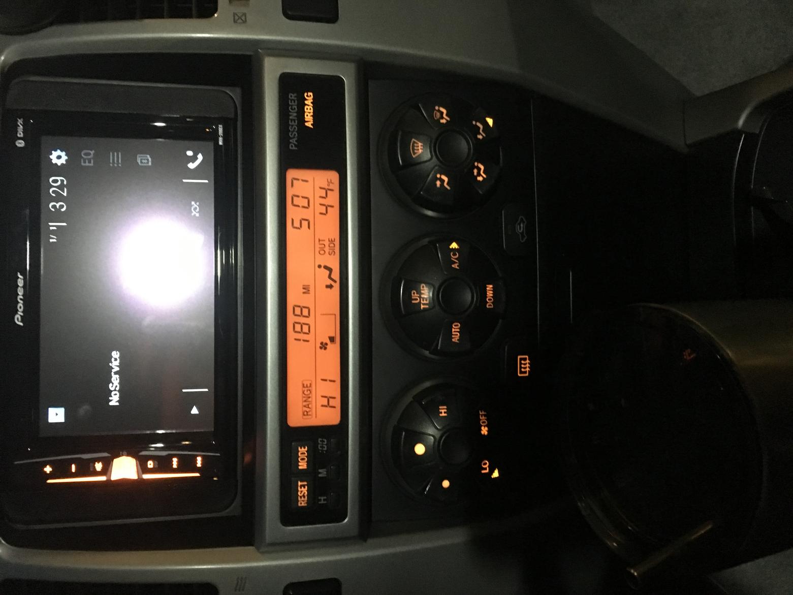

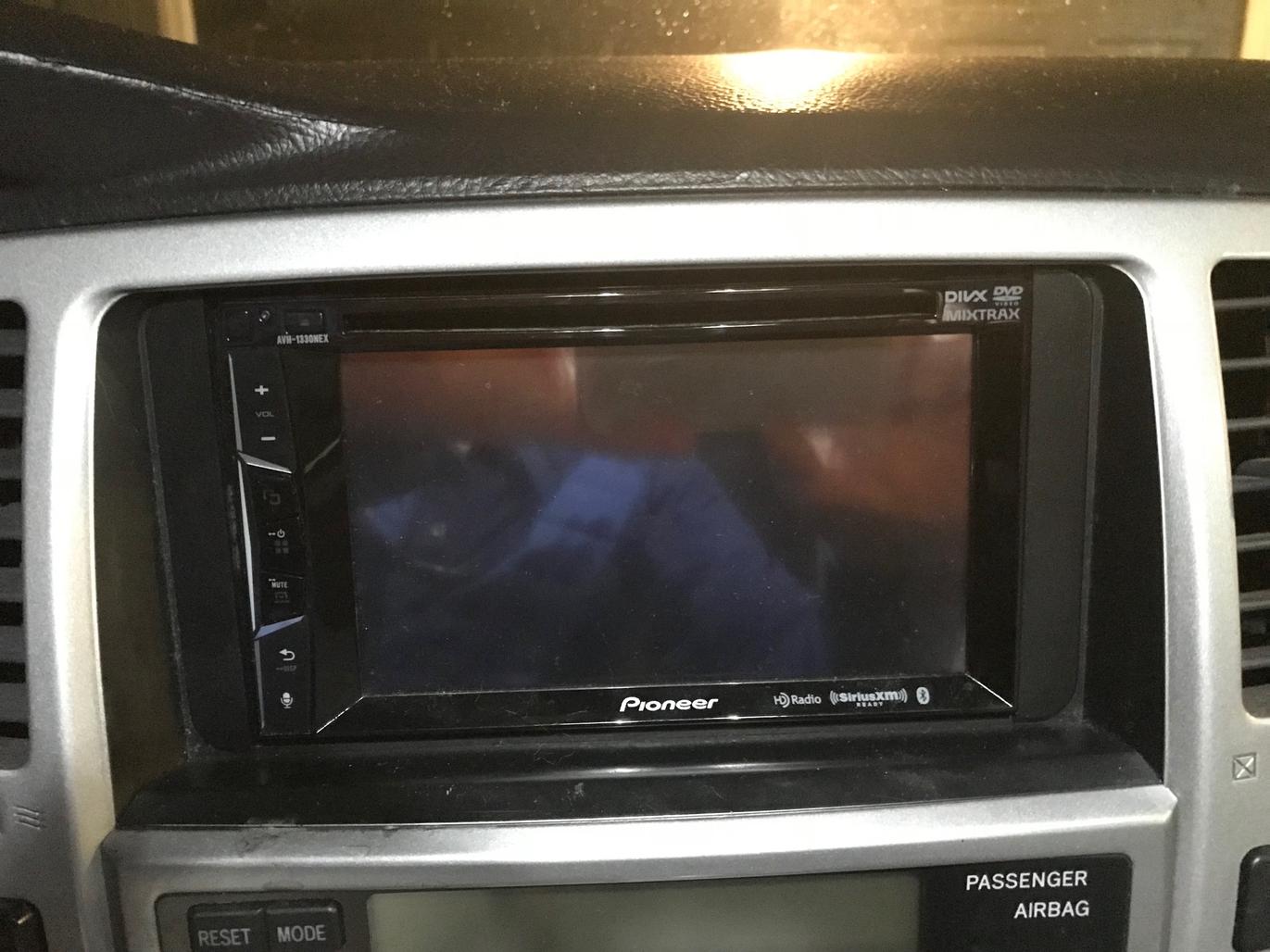

I have a 2005 4runner sr5. I added a pioneer double din. No jbl/rds. I hate the small trim pieces that go on each side. It is not a tight fit. And if you press to hard on the screen it’s like it will fall behind the bezel. My question is, what are people using to prevent this? Are there some other kits I’m not seeing that are better. It’s like there’s no way to screw the headunit in. I noticed on the single din it has 2 screws so it’s a secure fit. But wanted a screen for back up camera. Any help is appreciated. Thanks.

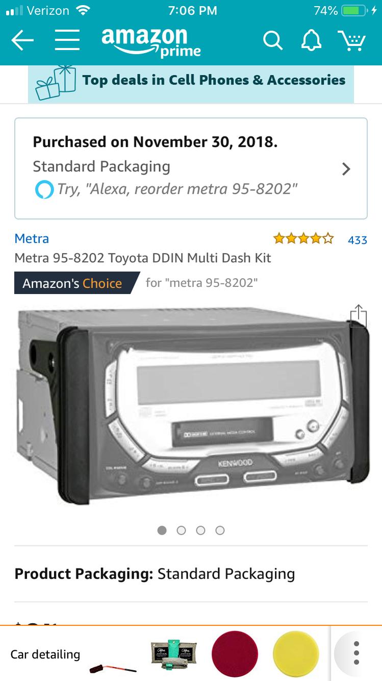

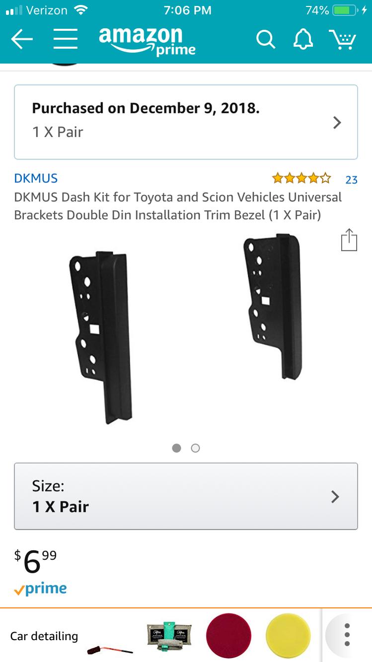

I’ve tried the metra 95-8202 kit and the Dkmus kit off amazon. It’s better than the metro but still not tight.

metra kit covers more. it makes it looks better. also with that, you do need to use the factory radio brackets.
you can also try the metra 99-8300, that has its own brackets. might be the cheaper way, but i didnt like how my single din with pocket mounted.

Hmmm .... Crutchfield sold me the Metra 95-8210 for my Pioneer MVH-2400NEX install and I'm not happy with it at all. It's a one piece snap on bezel and I had to trim off the top piece in order to get it to fit when trying to put the dash back together ... the end result is that the bottom of the trim is fairly stable, but the top of the trim is loose. I'm looking for suggestions from others that fit better in my 06 Sport. Both the Metra and the DKMUS that the OP posted look better because they actually attach to the head unit, but am interested in others experience.

a pic of what? the install or the kit itself? I can get a picture of the former, but not the latter without taking everything apart again. After looking at the Metra website, it looks like I have the newer 95-8210 ... I didn't use the brackets that came with it but instead used the original Toyota brackets (the original 6-disc changer JBL head unit was manufactured by Pioneer, so the brackets fit perfectly), and then had to trim the top piece off completely (it was clearly designed to do so) in order to get the receiver trim panel clips to fully engage.
