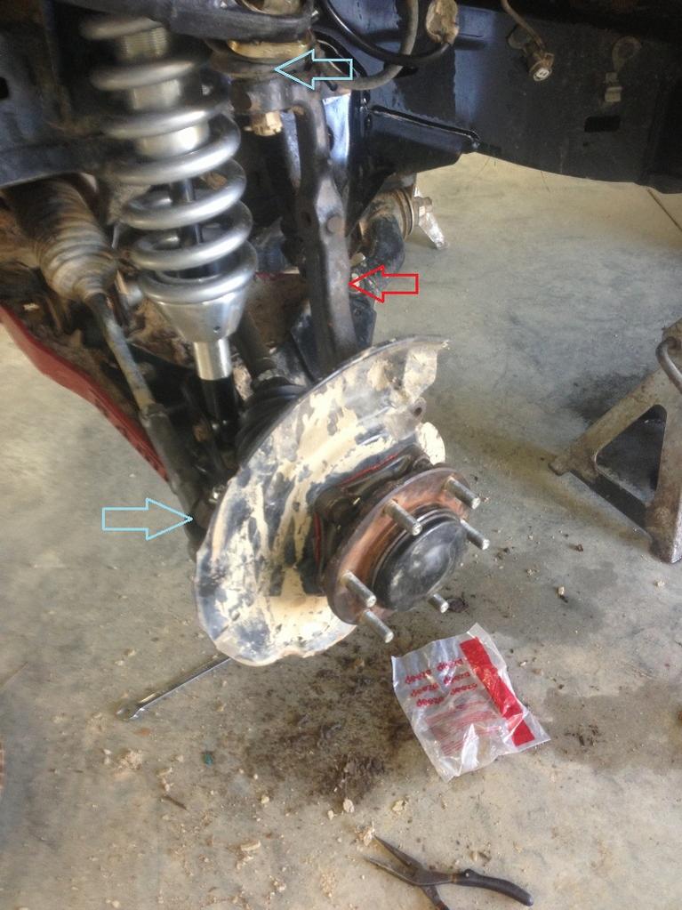

If they replaced the inner bearing seal inside the steering spindle then they had to disconnect the outer tie rod end links from the spindle as well as disonnect the upper and lower ball joints to remove the spindle and tap in a new inner seal.
when they disconnected all the ball joints its possible that they tore a ball joint boot, and or your alignments off a little after re assembling everything.
for reference, the red arrow is point at the steering spindle that has to be removed to replace the inner bearing seal. The blue arrows point to all tie rod ball joint and the upper ball joint that have to be disconnected.

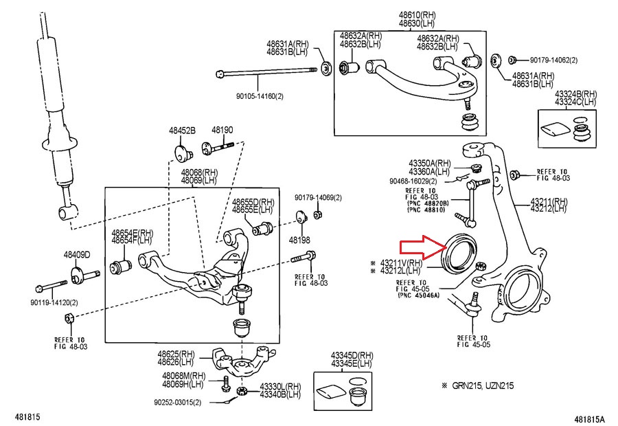

It's also best to change the inner seal inside the spindle. If not your just allowing debris and water to contaminate your brand new wheel bearing.
the Item with the red arrow pointing to it. It may not be as prudent in a 2wd truck I believe they have a cap on the back of the spindle that seals better perhaps.
