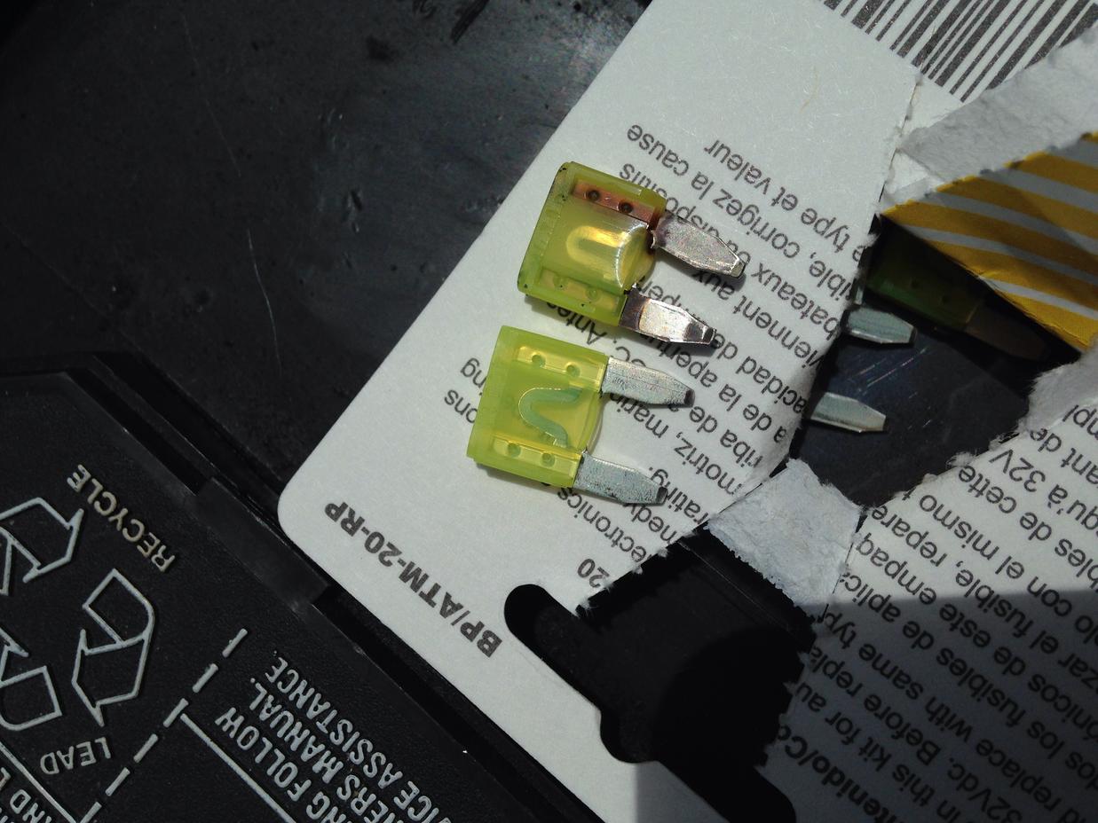

There's another thread on here by a guy who had similar problems and it turned out to be a bad EFI fuse. I checked that fuse and though it wasn't burned out, it has some kind of corrosion on it. With the fuse out the car won't start just like the past few days. With a new fuse it has started right up. Going to take it for a drive and see what happens. I think I've included a picture of what the fuse looked like. If it shows up it's the fuse on the right in the picture.

I have driven the car over 100 miles and started it about 30 times since replacing the fuse. So far it is working normally now. I'll be taking it back to the shop today and I'm hoping they can confirm the fuse was the problem.
