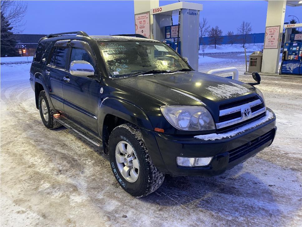

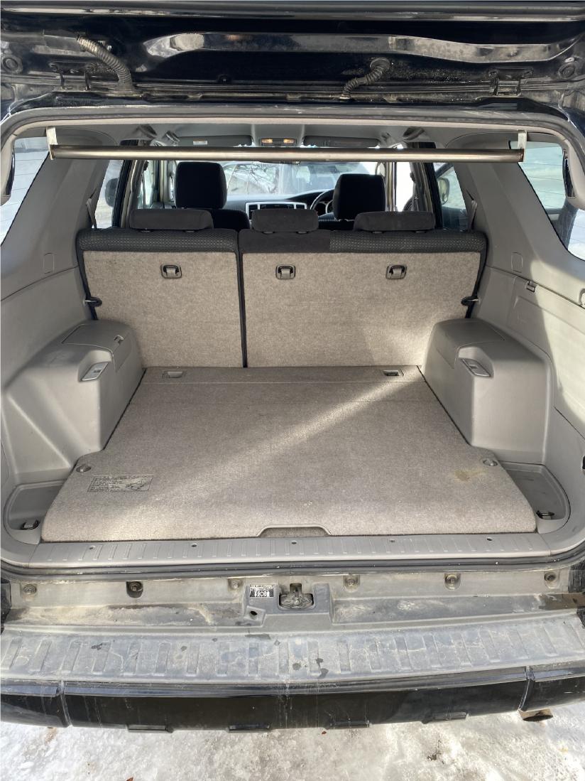

Hello everyone from Canada, I currently drive a 2005 Toyota Hilux Surf SSR-X 20th ANNIVERSARY EDITION, I recently picked it up after waiting 3 months for the vehicle to arrived from Japan to Canada. I'm not looking to do anything crazy build here, this will be my daily and want it to be comfortable to drive. This will be used to update my build and the process that's been done so far. If you want to know more about the 4th gen Hilux Surf I already made a post about it: Hello From Canada!.
Plans for this build:
Engine wise I plan to install a Oil Catch Can, K&N 62-1370 Vent Filter for the Secondary Air Pump, engine block heater, metal coolant bypass pipe (the plastic one is leaking coolant)
Exterior, undercoat the frame to prevent rust on Canadian roads, paint the chrome trim and a couple of faded trim pieces, 2" lift kit, trailer hitch, offroad tires, and a front push bar.
Interior, add a cruise control switch (hopefully it's plug and play, the Hilux Surf never came with cruise control switch), install a new head unit because the original one doesn't work here in North America, clean up the interior.

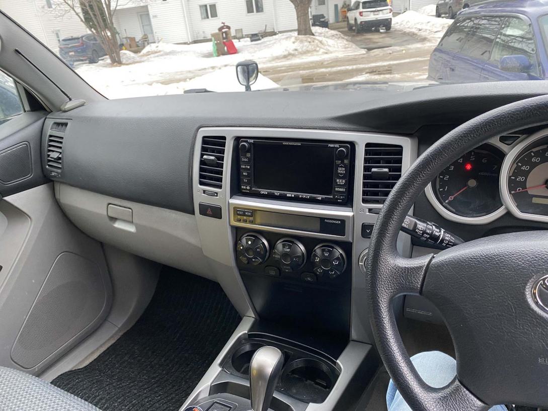

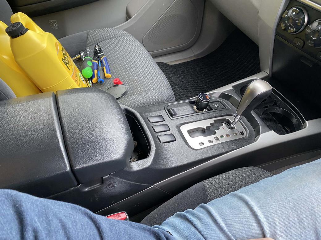

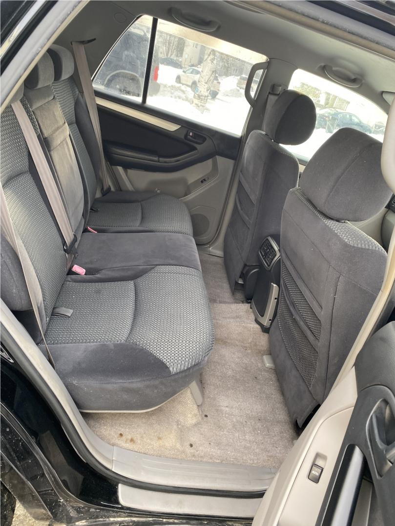

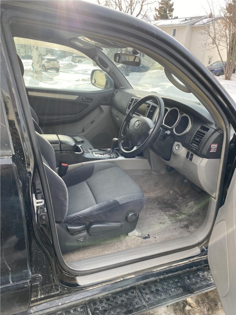

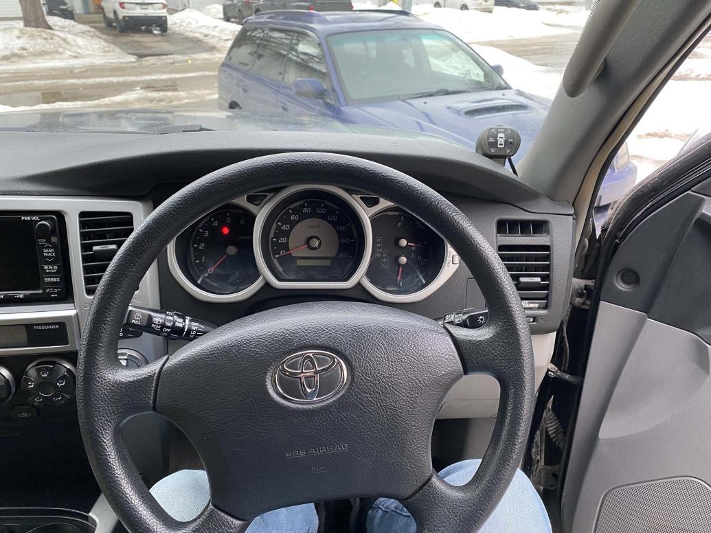

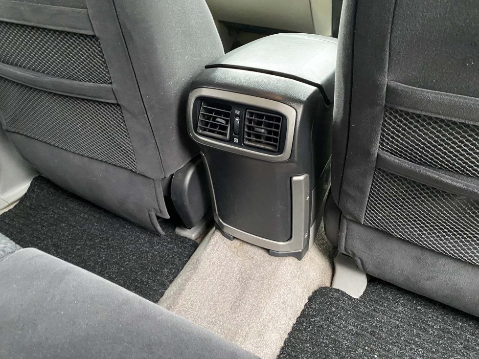

Here is the interior if you guys are curious about the difference between the North American 4runner and the Hilux Surf, nothing really other then being a right hand drive vehicle and no cruise control switch.

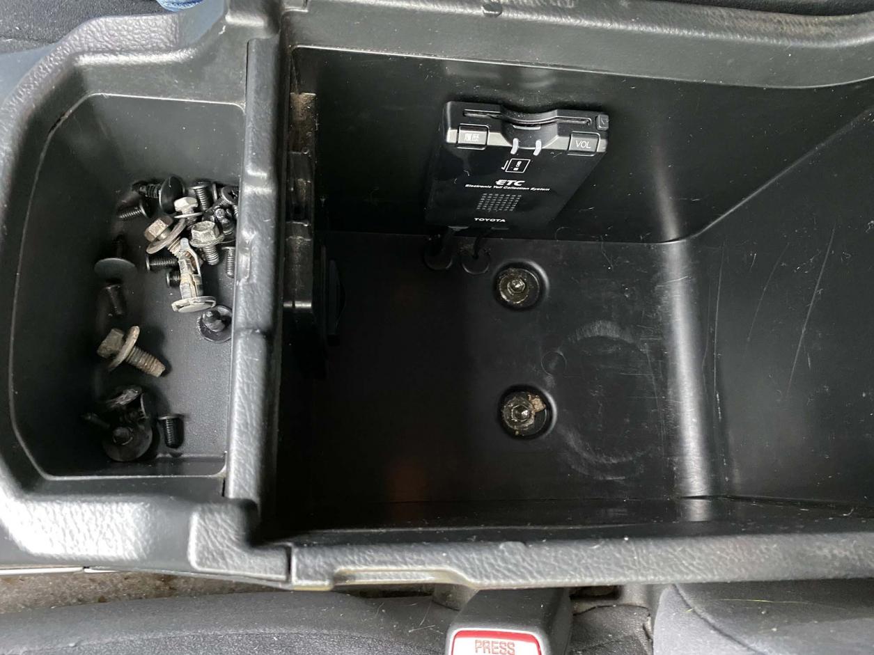

Have you got the ETC boxes in the centre console/armrest compartment?

I actual do have a ETC box in the centre console, hopefully once I pick up my cruise control switch I can confirm weather or not it's plugin play type of deal

Mine looks like it has receivers on the windscreen, but just needs the gear stick trim panel removed to remove the wiring to the boxes. I still haven't bothered and she whispers sweet nothings to me in Japanese every startup :biggrin1:

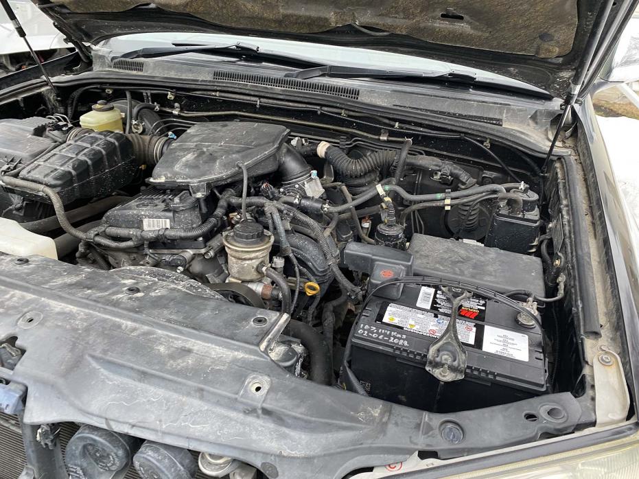

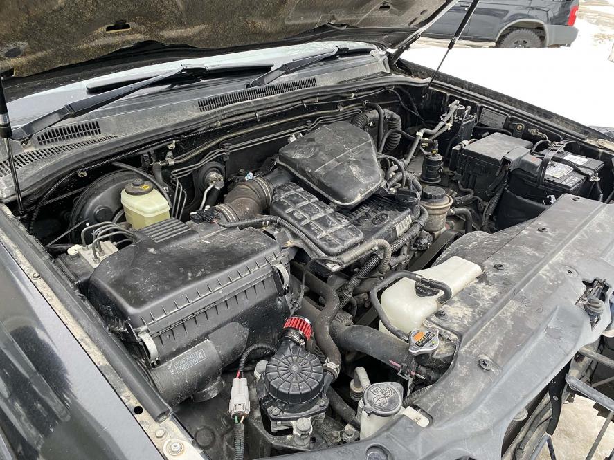

Here are some better pictures of the engine bay and interior. I did install the K&N 62-1370 Vent Filter, I definitely need a cover for it, if your wondering about the engine, it's a 2.7L 2TR-FE petrol, same engine in the 05 and up Toyota Tacoma.

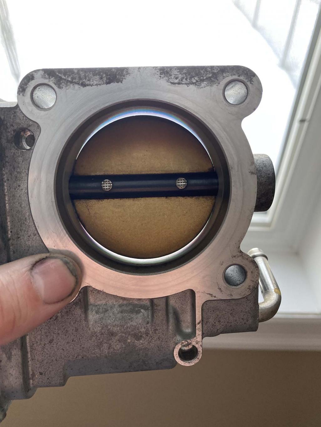

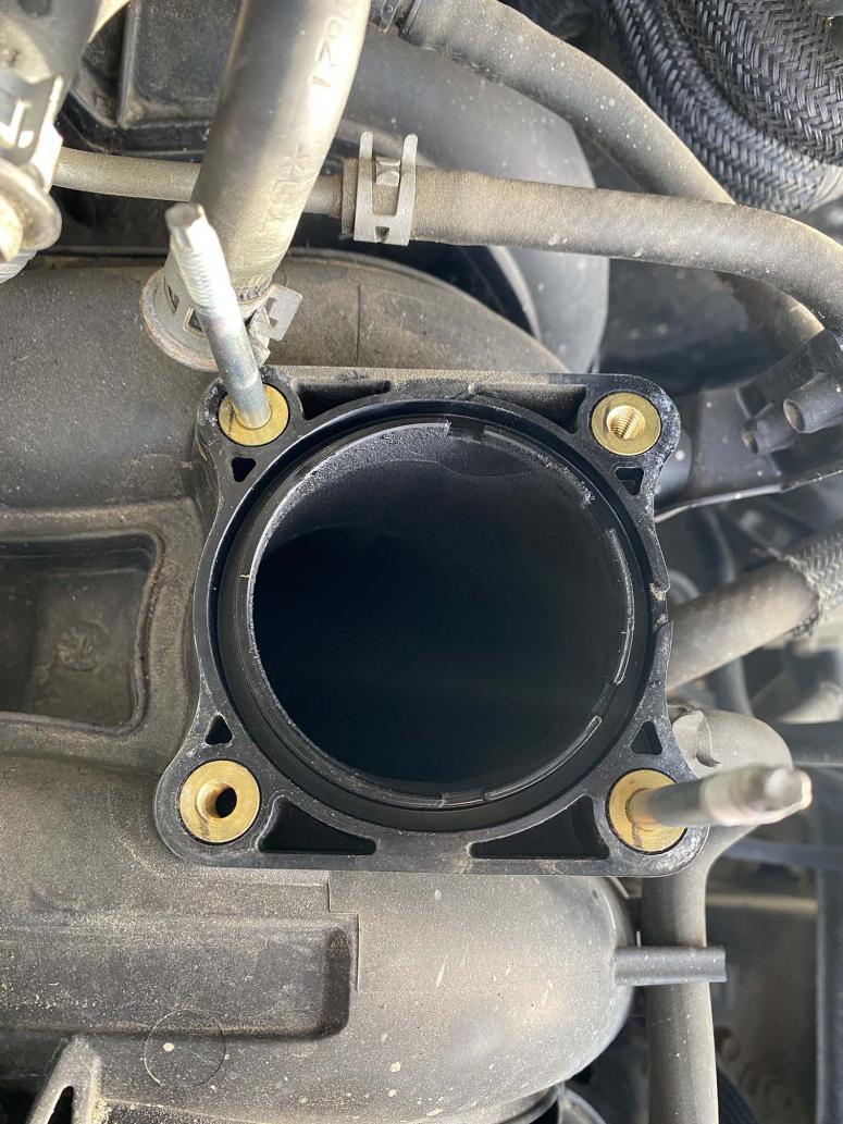

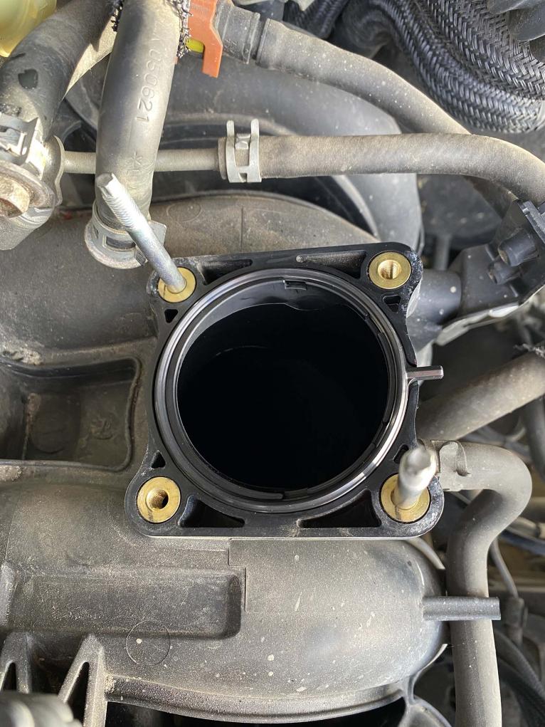

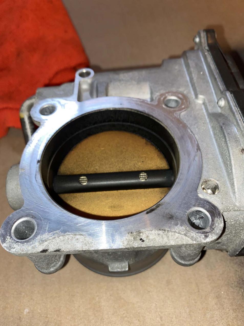

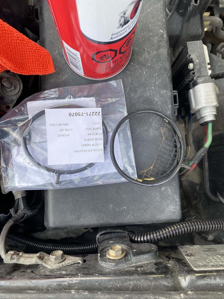

Update: (2/12/2022)

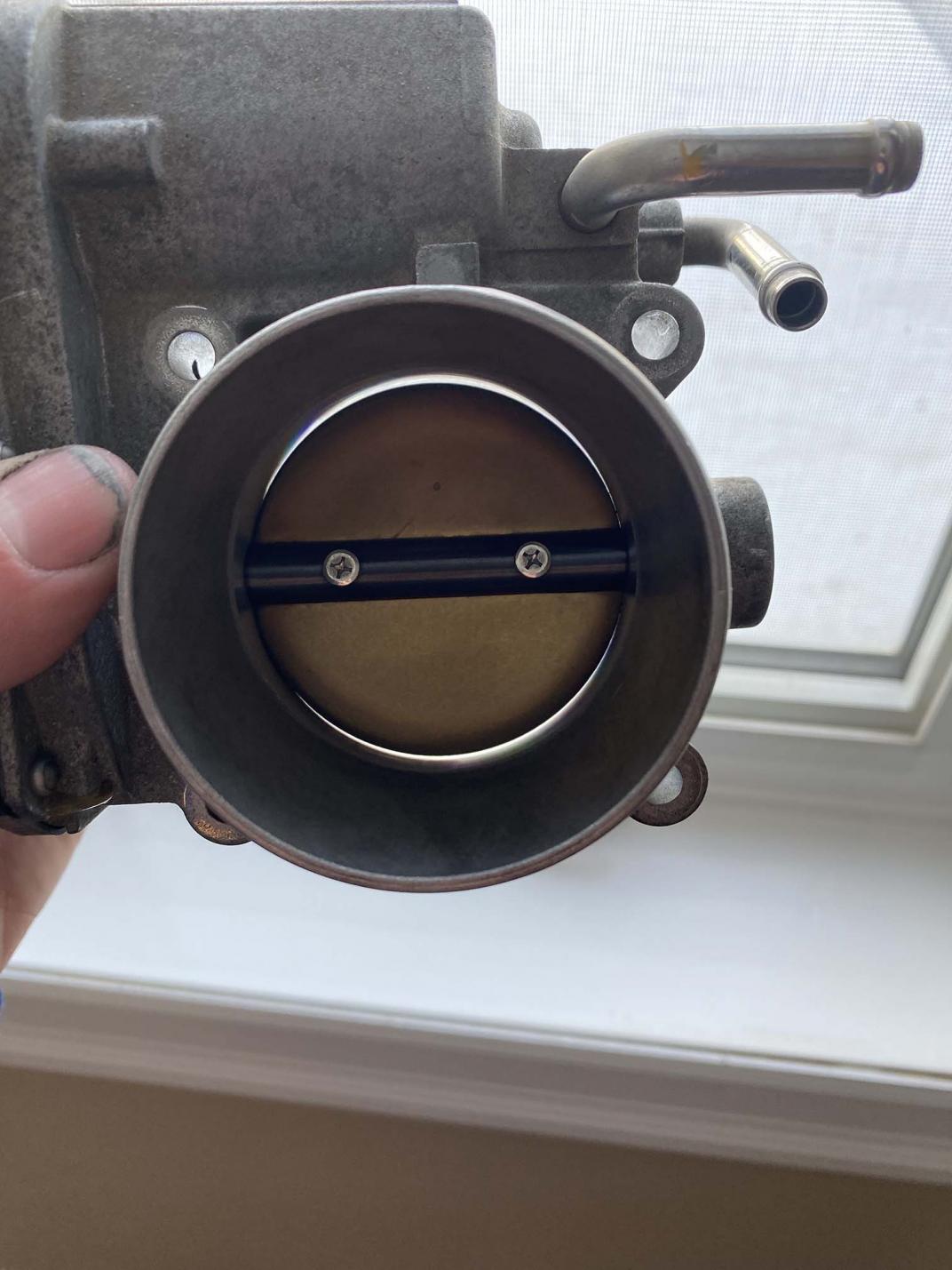

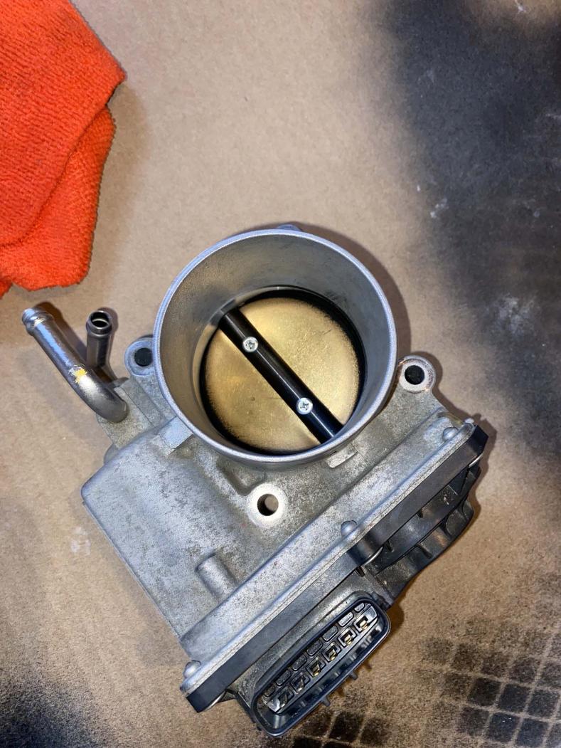

So today I removed my throttle body to clean it, when I pick the vehicle up for the first time it was idling below 500 rpm and stalled on me twice. When I removed it there was a lot of carbon in the pictures and gasket. After cleaning it to the best of my ability and installed it back in, I noticed a huge difference, once warmed up it stays idle around 800-900 rpm. Here's a video of the vehicle starting up
