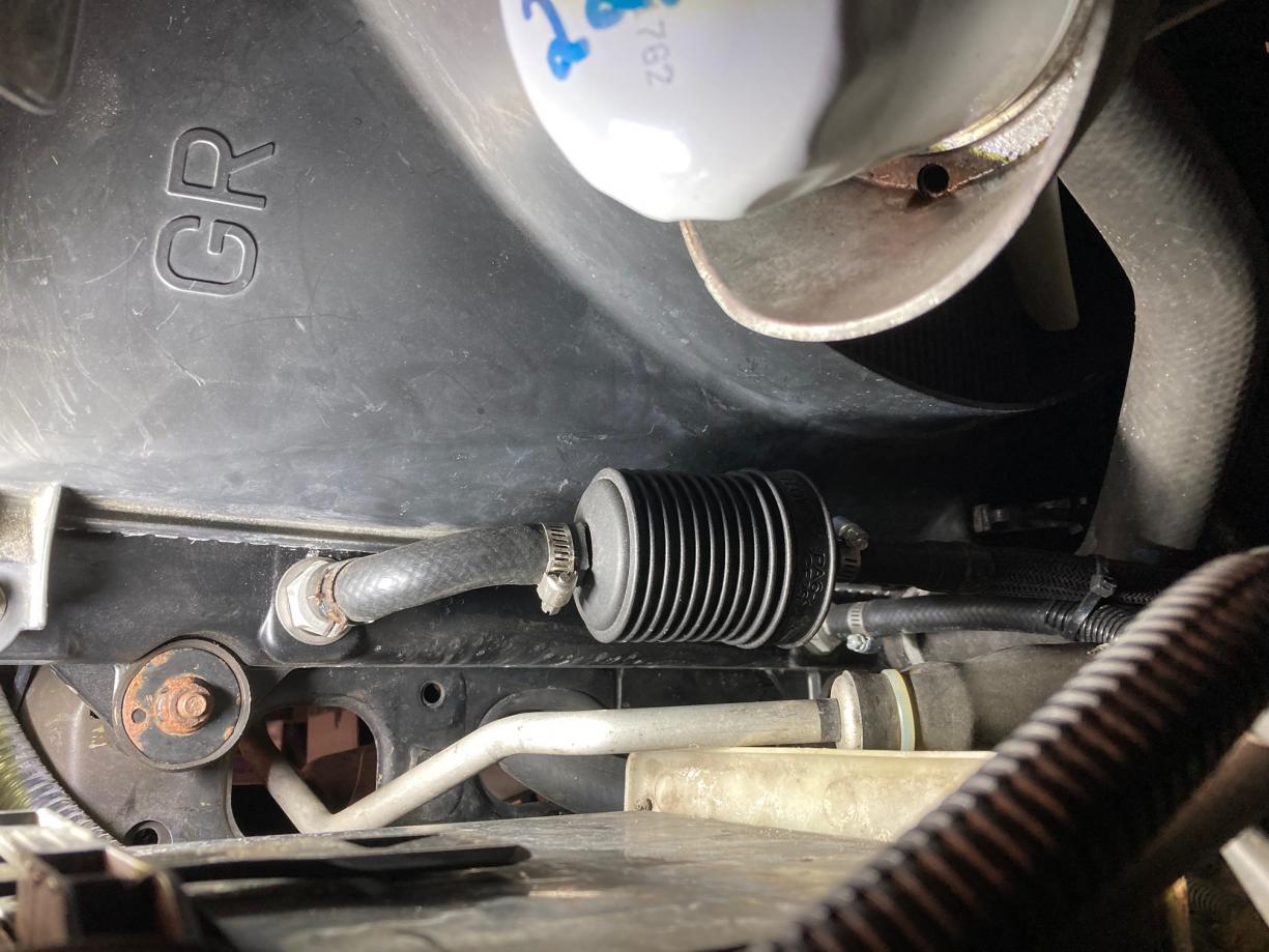

Before you add. That snake oil, install a magnefine filter to the cooling line. It will scrub the crap out of the fluid so the grit does not recirculate. I put mine up top by the battery so it can be replaced easily in 50,000 miles.
Thanks! I was not aware of this
Not snake oil, it works. It worked for me several years ago when my shutter started. Some time after that, I had the tranny flushed and filled at Toyota and a few years later, the shutter began again. [MENTION=78997]Drcoffee[/MENTION] , interesting device you have set up, gonna look into it.
I also put one on the power steering line too. You would be shocked what the internal magnet catches. Chunks of clutch material that would otherwise keep flowing thru the trans. Everytime you add tranny fluid it acts like fresh detergent and loosens crud to start moving again. I believe that is the primary cause of transmission failure after a flush. I put it after the cooler normally so the fluid has time to cool more before returning to the transmission.
