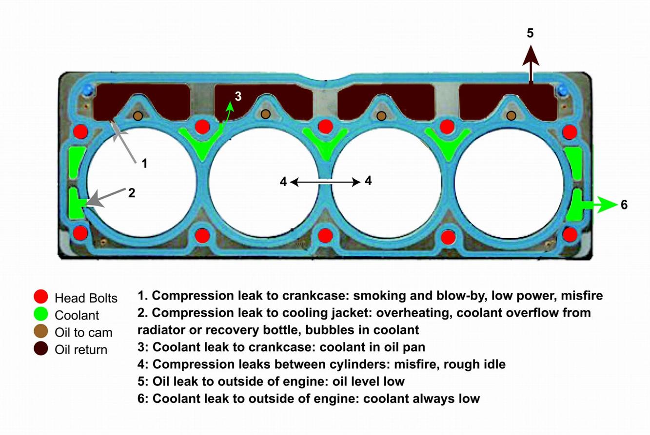

Many different ways a head gasket can "blow". Sounds like it has blown out to a coolant port/passage.
