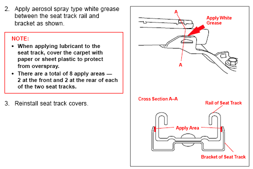

Toyota has issued a couple of general TSB's for seat squeaks.
NV004-06 talks about a noise made by the rails where they meet the floor. There's a pin sticking out of the rails that helps line up the rail with the floor during manufacturing. The pins are lined up with holes, and when the pins go in the holes, everything is ready for the rail to be bolted down. The pins are not actually functional, and they can sometimes cause a squeaking because they can move slightly in the holes. The solution is to remove the seat, cut or file off the pins, and then put the seat back in.
NV005-06 talks about a squeak in the rails where the floor bracket is attached to the rail. The answer for that is in the picture below, adding grease as shown.
Hopefully one of those ideas helps.

Hi Toto,
Thanks for the info, one quick observation I should probably add to this thread is something I feel when the seat makes the creak/crack. If I squeeze my arm between the seat and the center console and wrap my fingers around the bottom of the track (the rear right hand side track) when the sound occurs I feel like a pop or really bad grind. Is this the NV005-06 issue? I can actually feel like something in the track is popping or grinding pretty badly.
thanks again
It's always possible that something is broken, too.
The grease trick is cheap and easy enough to try, so I'd start there and see if it helps.
