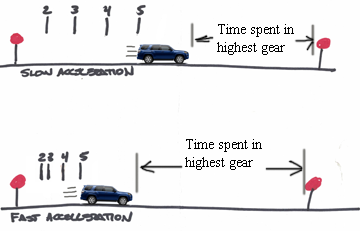

This is something interesting I figured out by accident.
Driving *slightly* more aggressively will give a bit better MPG than granny-pedaling it. For a few days at work I had to do a lot of running around town. I topped off the tank and did what I had to do, then topped off again when I was done. (Made it easier for expenses this way) I use the Fuelly app to track MPG, and I've observed that the dash computer is optimistic by 2mpg.
I noticed that by putting a little more mustard on it, my MPG was actually up about 2 mpg than the usual. I'm guessing this was because I was spending less time in the lower gears.
Makes sense to me... Consider this example with data harvested from what I remember while driving and thinking about other things and a highly scientific image to illustrate:
You're on a 45mph road, 50 miles long, with stop signs at evenly spaced intervals.
When driving granny-like, the engine is running slower, but it's spending more time covering distance in the lower gears. So the 2000 engine RPMs are being spent less efficiently until it works its way up to 5th gear.
When you accelerate a little harder, you get up to 45 mph quicker and the engine spends less time at higher RPM's with lesser output, and spends more time in 5th gear at a constant speed.
Just my theory with absolutely no math or science to go with it. One thing that always baffles me is the whole "You get better MPG on the highway going 45mph than 90mph" because I keep thinking "but the engine is running twice as long, so...."
Dutifully Submitted,
KC Murphy: Overthinking everything since 1972

Montego Murph summed the thread perfectly. LOL!
Ha! I'm just glad I'm aware of the neurosis!
You're on to something here, that is well known among the automotive engine designers. That is simply that your engine is most efficient at turning fuel into mechanical work at wide open throttle. At part throttle, it takes a surprising amount of energy to pull air past the partly open throttle - about 3-4 horsepower for a 4.7L V8 running at 2000 rpm. Given that the the rolling and air resistance of a 4runner only requires about 15-18 HP to overcome at 60mph, you can see that throwing away 4 HP at the throttle plate is a big deal. The losses are lower with smaller engines; thus the move over the years toward hi-rpm low-displacement engines. Also, things like variable valve timing (VVTi) and other such design changes can reduce those "pumping" losses.
So, when you accelerate briskly, you are actually using less fuel to get up to speed. That's somewhat offset by spending more time at the higher speed, where air resistance provides a greater loss. However, as you've found out, it is not necessarily always more efficient mpg wise to drive like a granny.
My 1994 with the 3.0 V6 gets slightly better mileage when I drive it aggressively (if you can use that term with a 3vze), wrapping it up to 4000 rpm before upshifting. The difference is slight, but measurable by carefully recording and summing up injector timing over a few miles.
