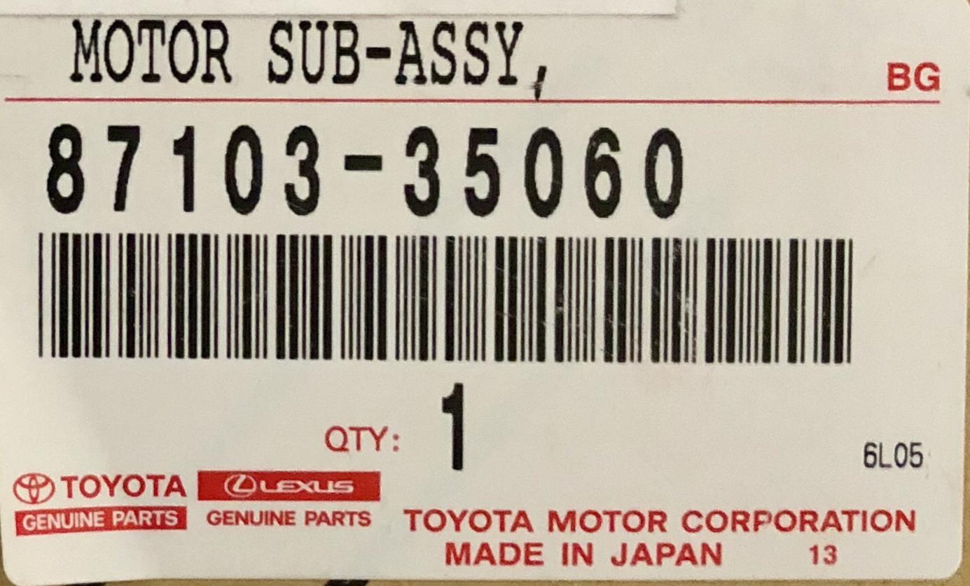

My question is would the steps and location of the blower motor be the same for a 2007? Also, how would I find the part # for the blower motor? I searched the forum before posting but couldn't see these questions answered.
Easy Swap 3 Screws and a Plug.

Toyota OEM factory blower motors at least for my 2004 seem to be available from many Toyota dealers online and also on eBay from looking just now.
Part number 87103-35070
The part number 87103-35060 posted above according to Toyota doesn't fit my 2004 but they seem to be available as well.
