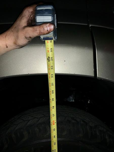

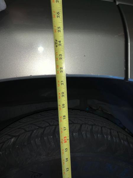

Ride Height with stock 4th gen suspension:
Ride Height as it sits was around 21.5 inches to center of hub cap.

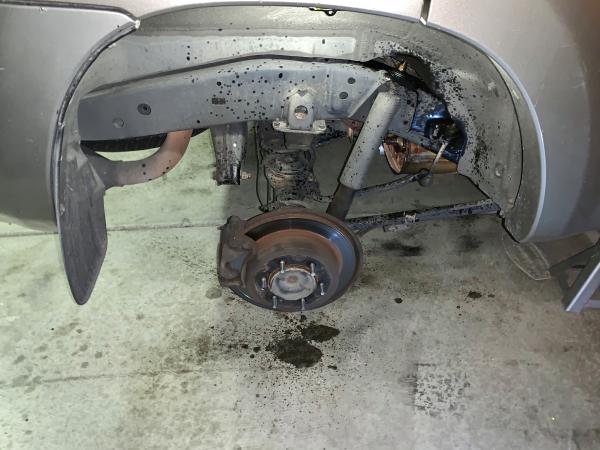

Stock set up of 4th gen:

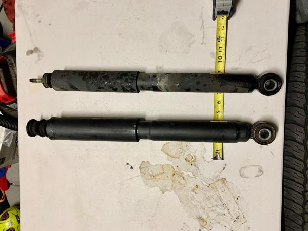

4th gen to 5th gen shock comparison:
As you can tell the 5th gen shock is slightly larger.

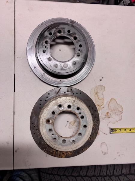

Stock Rotar vs Slotted Power stop

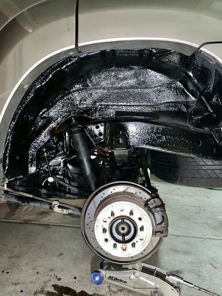

I had a set of slotted power stops in the garage so while I was down there I decided to swap them over.
Final install with cleanup and undercarriage liner.
Very happy with how everything fit and was cleaned up by the undercarriage liner.
Final 4th gen rear ride height with 5th gen springs and shocks.
As you can tell I gained a touch more than .75 inches in the rear and after driving it, I can say that the shocks and springs are stiffer, but the biggest difference is how planted the rear is in comparison to the front with the new sway bar links!

FYI if that undercarriage spray you used is rubberized (what most people use for liner-type areas) spraying it on the frame is a bad idea. Rust will get behind it/under it and eat away at what you cant see. It's kind of known for doing just that
Ya I was a little worried about that. I cleaned the frame first and removed any signs of rust, but thankfully there wasn't really any. I have owned it since day one back in 07 and it has exclusively been in Alabama and now Las Vegas. It rained a lot in Bama but almost never snowed and they don't know what salt is and then Vegas speaks for itself so I am not immediately worried about it, but I may scrape it off the frame in a few months. I did decide to just do regular high heat enamel paint on the front when I do it tonight.

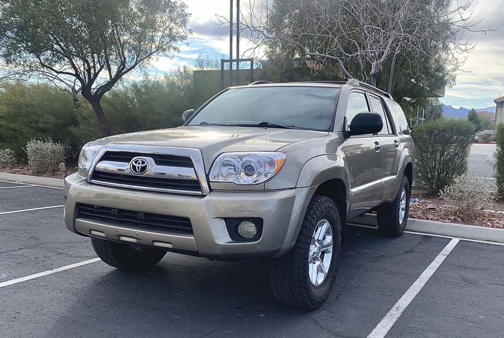

1/27/20 update!
Its been a few weeks since I updated the thread! Few things have gone down! Front suspension install, headlights, and tires! Outlining the process below!
Front suspension:
Suspension for the front was a little more difficult than expected. First the front struts are not 100% direct replace, so in order to make the bushing fit into the lower control arm you have to grind down the bushing on the bottom of the strut around 1.5mm per side and bend the mounts open a little. This process took me around 3 hours to complete.
One the strut is installed you will notice that the driver side sits about 1/2 inches lower than the right. From what I can tell this is due to the fact that the 4th gen is set up to accept a longer coil on the driver side than the passenger. The replacement 5th gen struts are the same length on both sides. To correct this you need a 1/4 inch aluminum shim to put on top of the strut assembly to give 1/2 inch of lift to the driver side (I know that doesn't make a ton of sense but its the truth). Due to the coils being significantly stiffer than the 4th gens, I have not noticed any droop when I sit in the driver seat. ( I weigh around 200 lbs.). All in all this netted around 1 and 1/4 inch lift in the front. So I now sit slightly higher and much firmer than the 1 inch spacers I had on before.
Front Head Lights:
After the suspension was sorted I then proceeded to correct 13 years of haze on the stock head lights. I ordered an after market head light unit that replicates OEM for $150+shipping off Carparts.com. They were great as they shipped and arrived in 1 day from LA. I proceeded to replace the OEM headlights which requires the removal of the front bumper. Result is excellent! Much brighter when driving at night! I also upgraded my fog lights to LED bulbs in the stock housings. They are not crazy bright but plenty brighter!
Tires and alignment:
Final step was to get rid of the terrible stock tires. I am running SR5, 5th gen wheels. I put on a set of Falken Wildpeak At's in 265/70/17 which is slightly larger than the stock 265/65/17's. I also got an alignment to make sure it drives strait and the tires hold up over time!
All in all its coming together well!
