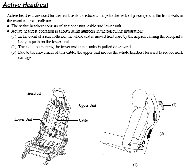

Below is an excerpt from the New Model Information about the 2008 Highlander (from TIS).
Although it doesn't help your case, I'll add that the New Model Information for the 2008 4Runner did not mention the addition of active headrests.

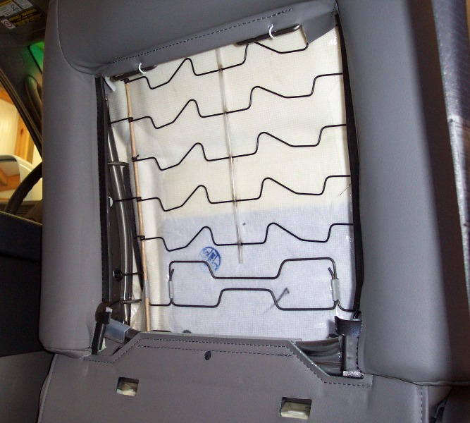

Hey Bob_VT here are a few pictures of the passenger seat that I had taken.

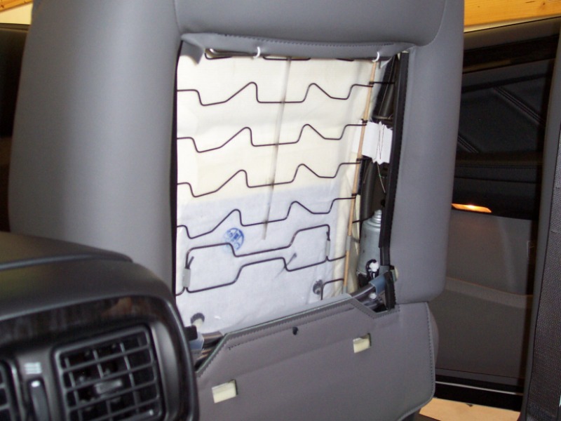

Second picture, on the far right you can see the side air bag but nothing pertaining to the active headrest system.

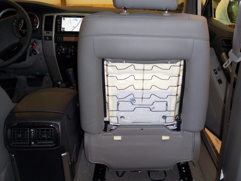

Last one, as you can see the active headrest safety feature isn't in the seats and there aren't even provisions to mount any of the mechanics of it.
