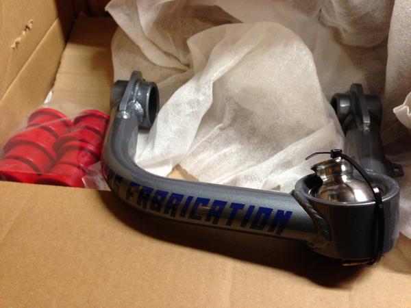

The project begins with a good foundation, suspension purchased from Metal Tech. A little present from Santa!
ICON 2.5 front coilover shocks
Total Chaos Upper Control Arms
