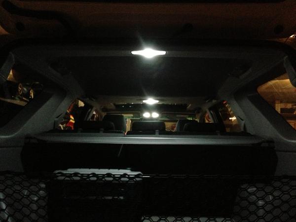

LED interior lights all around including doors, roof, glove box, and license plate. Just went to Superbrightleds.com and put in my vehicle information and it gave me a list of compatible LED's for the truck, easy.

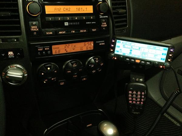

Also I finished my HAM radio mounting.
I purchased the Panavise mount and then fabbed an adapter out of some aluminum flat stock for mounting my radio and handset.
I used a wingnut on the back of the display mount so I could easily take it down and stow away when parked.

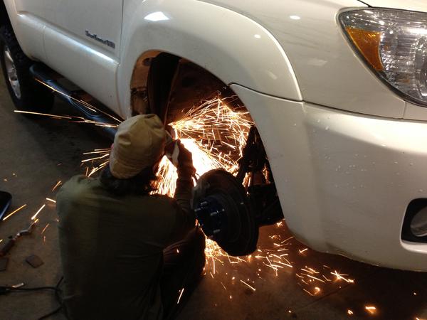

In your build thread. There was a picture of you grinding with an angle grinder or something during the install. What was that needed for?
That was LT from Metal Tech doing the front body mount chop. He was cleaning up the cut he just made and prepping it to weld on the plate. I wish i had a welder and 220 in my garage!
Nice start to your build. I really like how you have the Ham mounted. As for the Baja rack I think you will like it. I love mine. I have loaded mine up like crazy.
