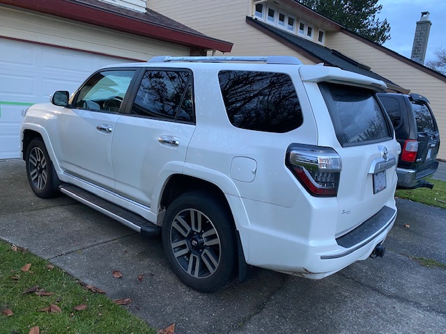

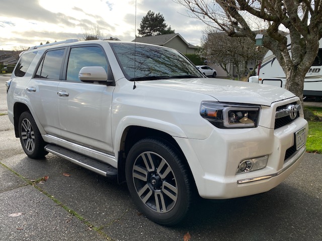

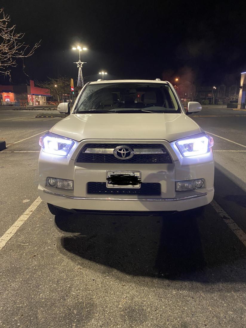

Photos on a white limited
So I just installed these lights on a 2012 Limited. My motivation was to update the dated look and mimic the newer limited. Took me 2-3 hours to install.
Robert at Spyder was fairly responsive. Price was decent but most of my headaches were with UPS.
Getting them shipped to Canada was annoying because there are surprise brokerage fees of $41 on top of the UPS shipping costs. So shipping and brokerage fees was almost half of the price of the lights. Also UPS lost my package and eventually relocated it after several phone calls and that delayed shipment by another week.

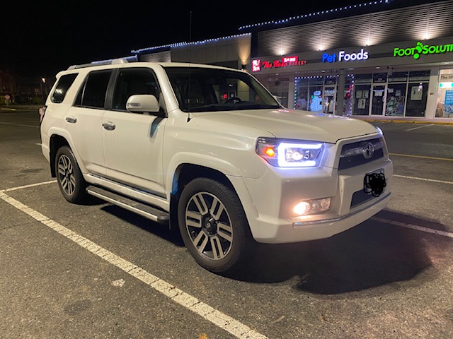

I really like the look of the headlights. At first I was wondering if i should go for the all chrome or the black version of the sypder lights. I eventually picked the black version and was super glad I did. The black colour gives it more contrast to see the details of the modern light design. It helps refresh the front. I also installed aftermarket taillights to mimic the newer 4Runners and changed the wheels to have the black outline.

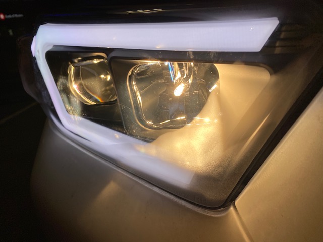

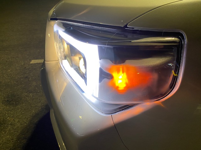

I installed it outdoors in 2 degrees celsius weather and prior to installation the headlights were sitting at room temperature in my home. After installation there was some hazy condensation inside both headlights (see close up photos). I checked again next morning and i don’t see the condensation but i definitely will keep an eye on that.

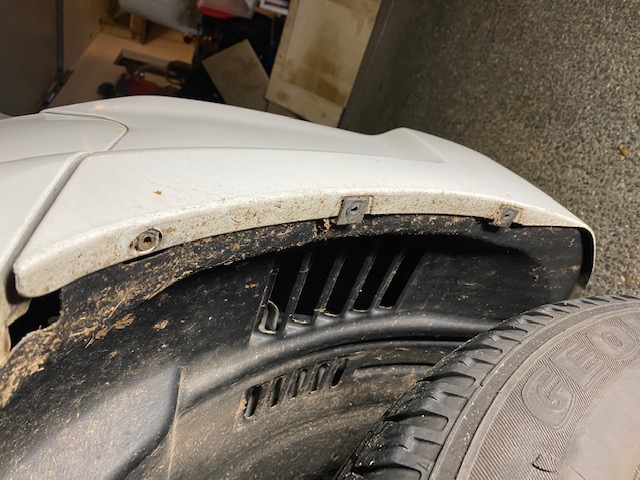

In terms of installation, pealing the bumper off was the most annoying. I was yanking on the black bumper bracket instead of carefully unhooking the bumper from that bracket (pay attention to unhooking the top screw hole of the three screws you are supposed to remove from the wheel well... see photo). i ended up damaging the bumper bracket. I saw videos where people were saying to yank on it hard and i did and i regretted that.
Also make sure the polarity of the spyder LED side parking lights is correct before putting the car back together. There is a 50/50 chance that it’s the wrong way and need to plug the light bulb adapter in the opposite orientation.
I took some photos and hope it will help others decide if this is the light for them.

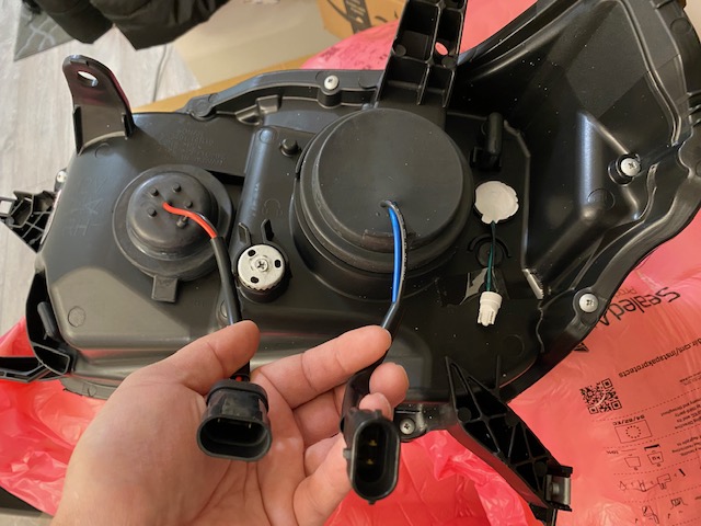

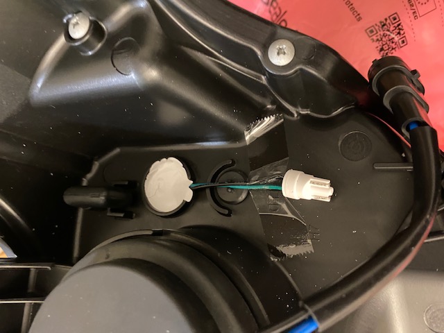

Glad it helped. I did use the supplied spyder bulbs. Like others have mentioned the output of the light is not significantly different from the stock bulbs. My only concern is the life span of the spyder LEDs (ie. amber side marker and the white accent glowing bar). These seem to not be user replaceable and if these LEDs die then I believe the entire headlight assembly needs to be replaced. See photo of the backside as it looks the LEDs (powered by the green and black wires) are inaccessible. For this reason, I am keeping my stock headlights as backup.
