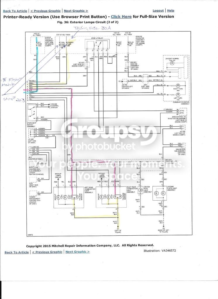

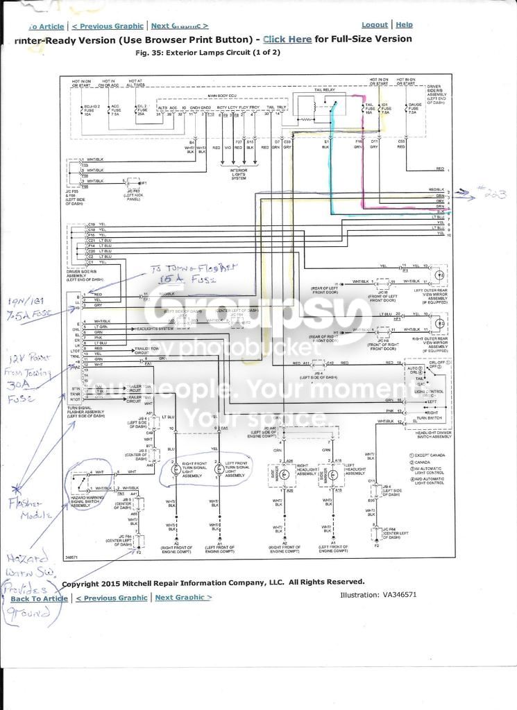

I've looked at and provided the wiring diagrams for your truck. Chances are, you've got a blown stop/parking lamp/License plate bulb with a dangling filament creating your trouble. I would remove each bulb, one-by-one with a visual analysis, paying close attention to the filaments within the bulbs! Drive the truck (carefully) without any of these bulbs in their sockets and see if the problems go away!
Then examine the bulbs that you removed. Upon examination, you'll likely see the X-circuiting in one of the bulbs. When you've determined which bulb is blown, remove it and return the others. Replace the blown bulb with a new one from your local 'Auto-zone' parts store, and test the stop lights again... the trouble should be resolved! Please be sure to let us know how you make out!
In the wiring diagrams below, I've traced the Tail-relay HOT circuit in pink (wire #5), the power source circuit (from the Alternator) in Blue (wire #6), and the GND circuit (WH/Blk stripe) in yellow (very pale); for easy viewing! "see below":

Measured Resistance between Green and Black/white pins on O12 & O13 tail light connectors and license plate bulb connectors. Reading non-zero resistance at all connectors so there is a short somewhere, as there should be no connection to GND with all those removed.
After reading schematics, found Junction Connector O19 in the rear pillar and disconnected. This would isolate each bulb so I could find which had the short. Remeasured each connector and now reading no continuity for both tail/brake connectors. Still reading non-zero resistance at license plate connector. So the short is somewhere between the license plate lights and O19 junction connector!
