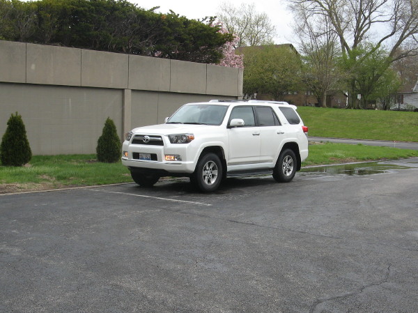

I set my front 5100's at .85 and the truck looks nearly level, with just a very slight rake.
