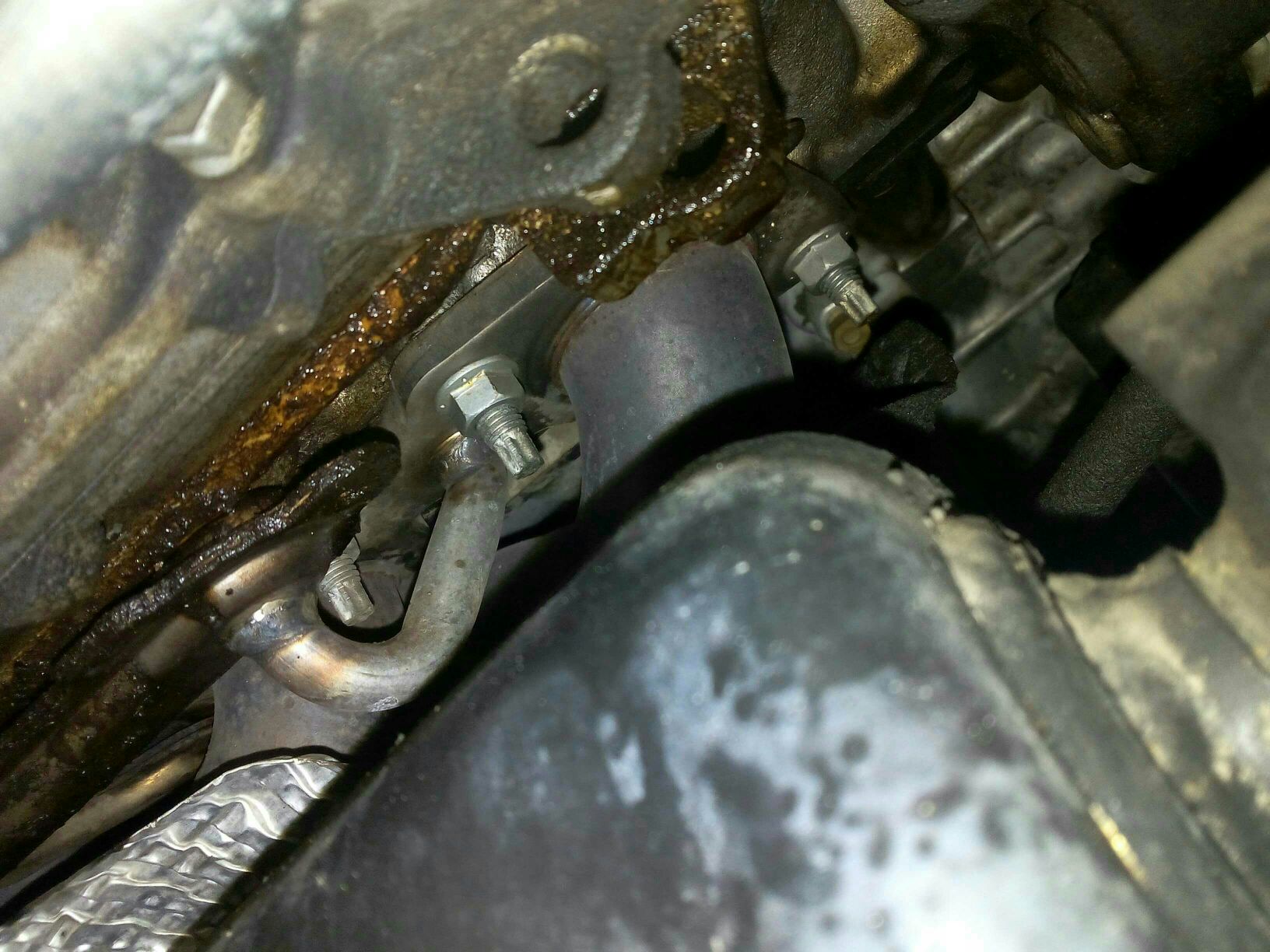

Anybody know the name of the seal or gasket right underneath the valve cover gaskets.. I got some kinda heavy leakage going on there but its not exactly the actual valve cover gaskets.. Anybody can help?
I just got an actual print out from Toyota and I'm thinking its actually the vc gaskets.. Just the way it looks in person like its multiple parts together but it may just be one big part
Possibly the cam tower seals are leaking. The job to replace them is not for the faint of heart. $3000 and up is the going price I believe at dealers.
