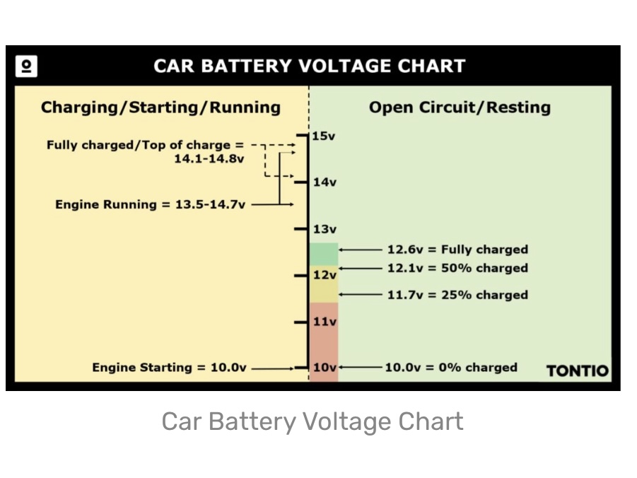

Do you have a voltmeter?
After resting for a while, a fully charged battery should be about 12.6V.
If it’s 12.2V it’s about 50% discharged.
During starting a healthy car battery voltage should be 10v or higher.
The voltage, when the engine is running, should be in the range of 13.5-14.7 volts, indicating the alternator is doing it’s job.
You could also take it in to an auto parts store to have them load test it.
