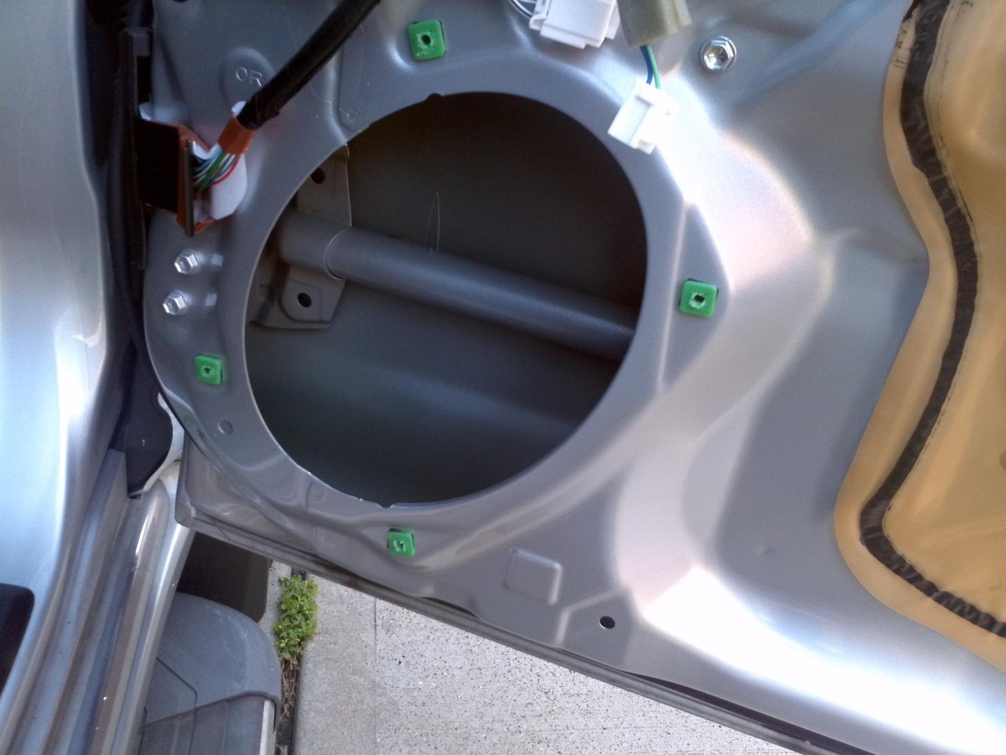

the door openings are not 6X9, there is no adapter available. I ended up using the stock speaker as my adaptor by modifying it. Also the way toyota has the front door/dash wired in series made using the existing wire difficult. I ended up running a new pair of wires to feed the cross overs. The tweeters are in the dash location, the woofers are in the doors. I believe I have the shallow mounts, also by using the original speaker frame as an adaptor, it gives an inch or so spacing. so to answer your question, I think the DXi separates would be a fine choice, I almost chose them, but you are still going to need to fabricate some sort of brackets to mount the door speakers.

I am also in the middle of audio system upgrading. I have already installed front components and hatch door coaxials. The amp and sub are on shipment.

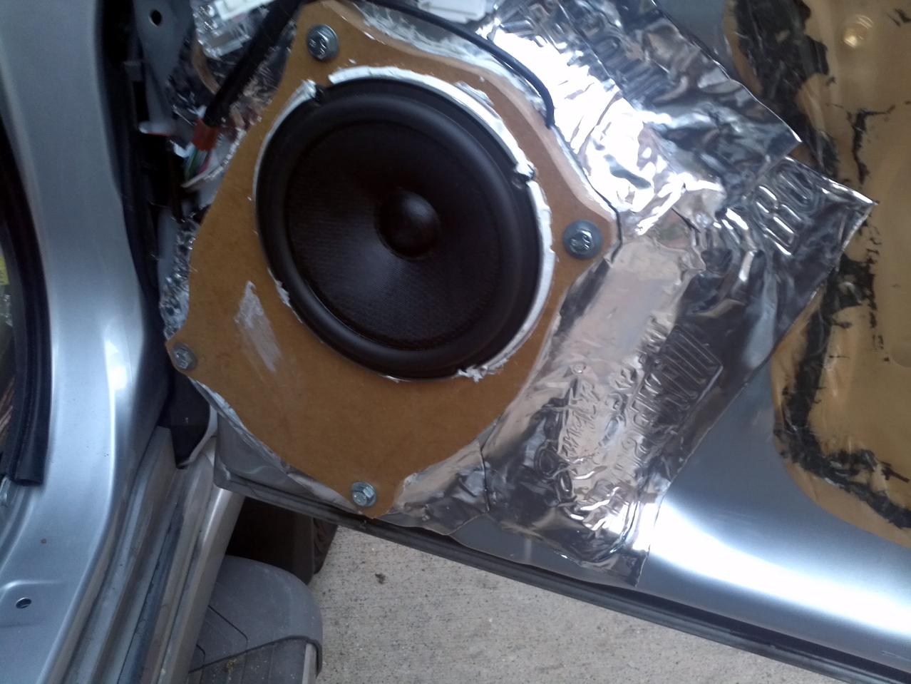

Regarding the door speaker compatibility, I don’t think you should have any concern. No matter how Crutchfield says, there is no speaker directly fit without customized adaptor (you can crash the factory speaker and reuse the mount or make your own adaptor). There is plenty of space between the mounting metal sheet and outside door sheet. You also want to bring the speaker rim closer the grill on the door panel by adding spacer.
The bottom line: you should only consider the slim mount if you believe it will sound better.
I attached a couple of picture for your reference. The MDF adaptor was so easy and should not be a problem for a professional installer.

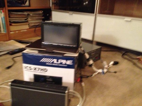

Here are some photos from installation:

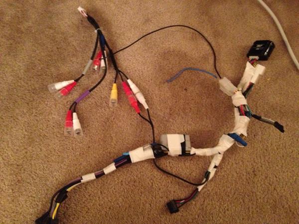

This first one, is a little blurry, but basically I floor tested everything before I put it into the car, made the actual install only 10min or so. I used my bose portable speaker and connected a headphone jack to it and one of the rca outputs, built the wiring harness, with tr7 bypass so I could get into the settings. Used my ipod as an audio and video source to test ever thing out.
Here is the harness I made. while testing I shook it around to make sure nothing was loose. I used white tape to make it easier to spot trouble. every wire was kept to original length used or unused, so that I can peel away the tape and everything is pretty much original condition. I used posi-taps and butt splices for all connections. I tapped everything into the adaptor harnesses wiring so none of my toyota wiring has been disturbed. this seems excessive I know, but if I have to troubleshoot a ground loop or something, I want the problem isolated.

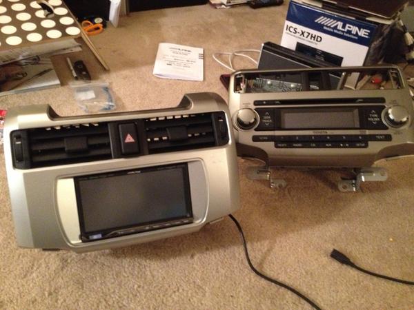

Here is a photo of the original radio next to the alpine. The vents and hazard light switch needed to be transferred, 6 or 8 small screws, and some clips. the Scosche is really nicely designed, tabs match up with the toyota holes, though only 2 of them, and the plastic brackets holes lined up with the holes on the alpine, side to side there is almost no gap and it sits flush, on the bottom there is a little gap 2-3mm but not noticable since the bottom edge of the alpine sticks out. the trim is a little scratched up as it has been sitting around for 18 months or so while I tried to decide if I was going to change out the head unit. I have another one in pristine condition I will change over to once I have everything 100%.
axxman-albums-mrslate-picture18744-scosche-adaptor-after-x-ferring-vents-hazard-button.jpg

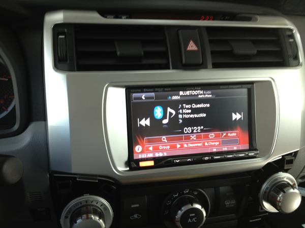

And here is the final result, installation was so fast I didn't have time to take photos, everything was just plug and play. I am still waiting on a couple of parts so I can connect the backup cam and iPhone, and I will remap 1 of the steering wheel button, so those photos will have to wait.

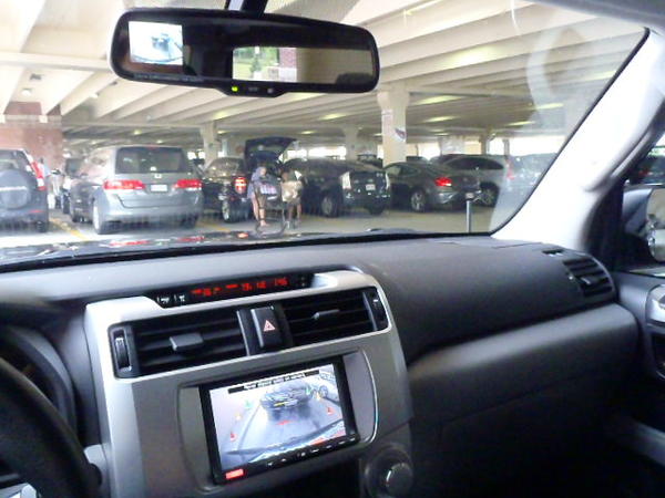

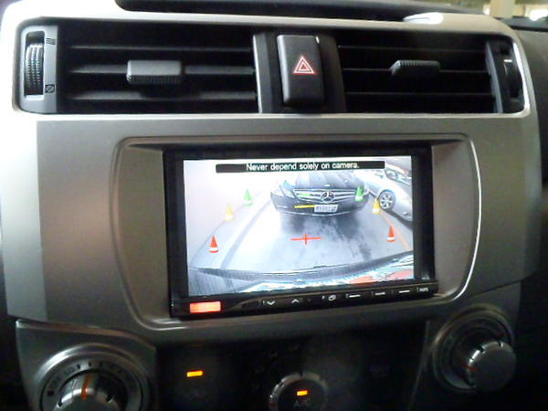

Managed to get the backup camera working today using advise from members on this forum as well as forums from other sites:
Both displays at the same time.
Here is a closeup of the display
Additionally, I was able to connect the factory USB plug to the Alpine.
