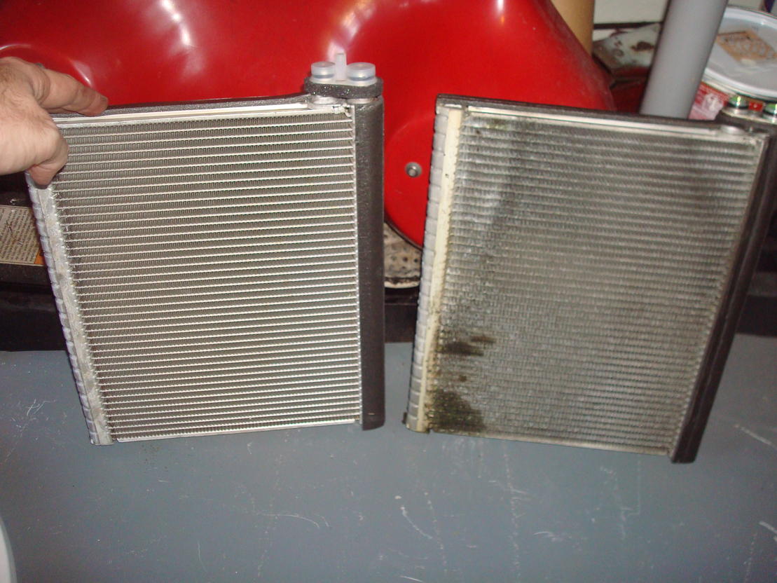

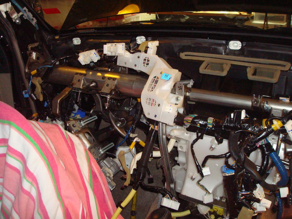

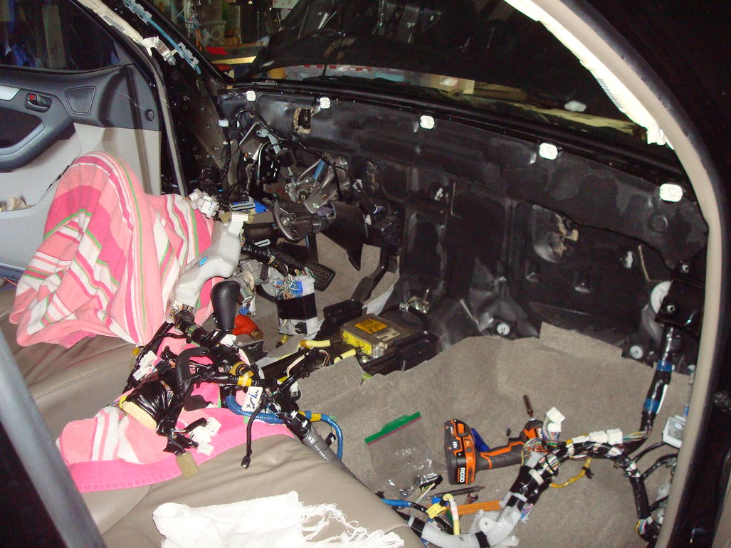

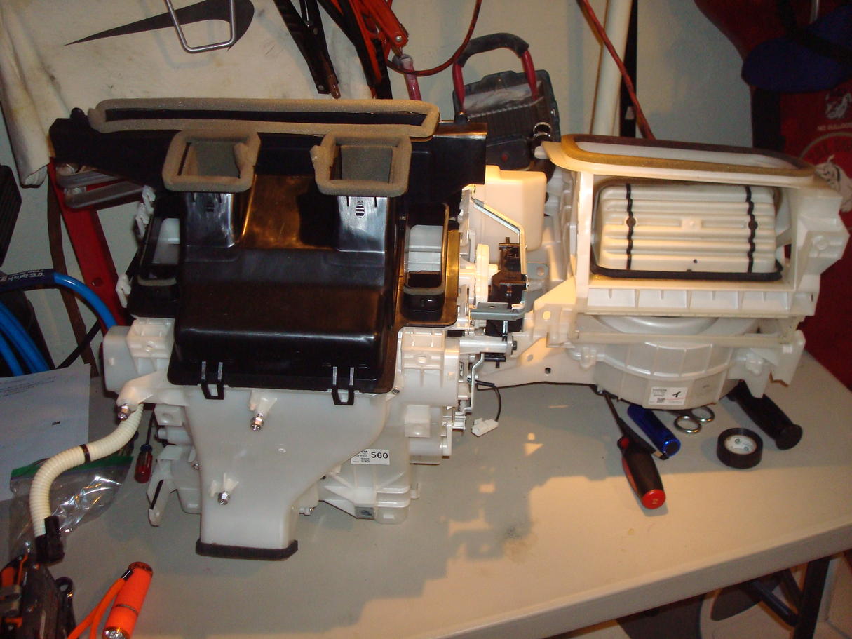

I had this happen to my 2008 with 150k on the clock. I recharged it and it took a month or so before it got hot again. I had a hell of a time trying to find the leak. There was UV dye in the system from a previous service, so I got a loaner UV light from autozone and looked for the dye around the system. I finally traced it to the evaporator inside the vehicle from the condensation dripping on the floor that the UV light fluoresced. bummer. I had heard the quotes to fix it were steep, and I don't trust anyone to put all the bits and pieces back where they came, so I tried it myself. The parts were cheap ($250 or so) for the evaporator core and I also replaced the expansion valve. Took me 1.5 days to do the install, but it fixed it and blows really cold now. You also need to replace the dessicant since the system will be open for so long. Since it was already discharged, I did all the work in my garage (pulled vacuum and recharged w/manifold gauges). Plus I know every nut and screw went back where it came from.

It's not as bad as it looks. If you bag and tag the hardware and take a lot of pictures it goes back together pretty well. Toyota was smart in that they use a lot of different connectors so you cannot mis-wire the harness.
Based on the pictures of what has to be taken apart I can see why the cost is so high. Ouch.
As was stated, it's not too bad. If you're new to wrenching or just not very confident it can be a bit of work. But honestly I have gotten pretty good at pulling the HVAC units out of Toyotas since I do a lot of rodent infestations now.
