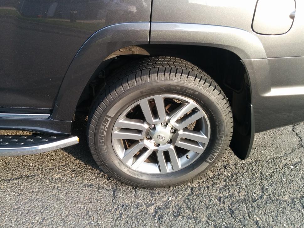

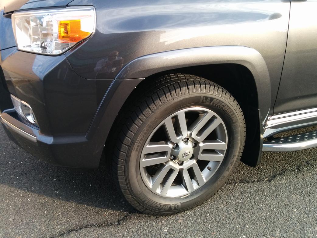

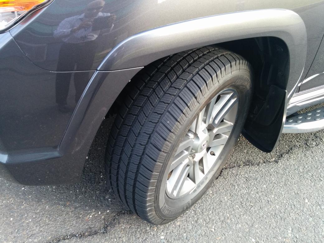

Thank you to all of you for your input. I ended up going with the Michellin MS2 and am very pleased with the tires! Quiet, smooth and I have NOT noticed any drop in mpgs. The tires fill out the wheel well nicely. Pics attached!

NICE! Sorry chime in late here but I had the same decision a few months ago. I think the reality here is that you need to be honest with yourself. Do you want to spend the money on A/T tires that you may run on the pavement more or just be honest and get some boring looking All Seasons.
I made the hard choice to go All Season since that is really what I drive and the fact that I would just kill some A/T tires. I just got stock size Bridgestone Dueler HT. Offroading in Western NY is not exactly easy here. We have so few trails to run on and most are cut for those little Wranglers. I think next go around I will change over to 17" wheels and tires.
Hope you enjoy the new shoes!

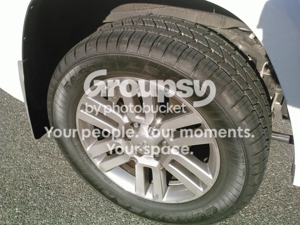

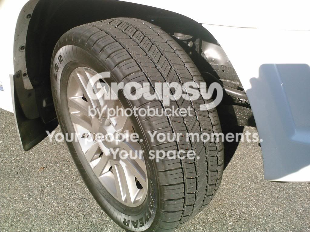

Here's another example of a 'Beefy' all weather tire; the "Good*Year" 'Eagle LS-2' 275/55 R20... (Stock rim/No lift)! Rides fantastic; particularly on the highway @ High Speeds and on sharp curves. These tires keep the truck planted on the asphalt and the X-REAS suspension system helps to keep that body/frame unit very stable and under control! I paid about $760.00 for all four tires w/ mounting/bal included, plus an $80.00 dollar rebate from GdYr; may still be available!
