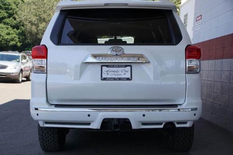

I want to uncover the factory tie-down loop in the rear to use as a second recovery point. I have a shackle hitch but want a second point. The stock bumper completely hides the loop though. I don't really want to spend the bucks on a new rear bumper so I'm thinking of just making a cutout in the bumper to give access. I'm not very artistic though and if I just go at it with a dremel or whatever It's going to look like crap.

Because the bumper is in the way! The faux-diffuser outlet hangs down lower than the tie-down point. If you wanted to pull down (i.e. tying it down) on it it wouldn't be a problem, but straight out the back the strap has to wrap under the bumper. Wrapped under the bumper plus pulling hard enough to move a stuck truck equals broken bumper.

I trimmed that whole lower piece off my 2014 Limited to make it like an newer SR5. That lower piece was a pain and always was hard to clean all the dust and dirt out of it. Now I can connect my trailer lights easily, I have access to the tow hook, looks much better and increased the ground clearance in the rear.

If you cut a notch you limit the angle at which you can recover without damaging the existing bumper. The second issue I see is anything that hangs down low enough to clear your bumper will lessen your departure angle, you are going to drag that recovery point sooner.

That's kinda what I had in mind - did you just go straight across at the top of the "vents"?

I went across the top of the vents. It was kind of tricky on the outer ends. I had to make a cut going towards the rear tire to be able to push the panel up.
One side on mine came out better than the other because I had more experience after doing the first side. I also made brackets to reattach everything and had to cut down some misc. black pieces underneath. Tin snips work great for cutting the plastic. You will not get a perfect straight line along the cut because of irregularities in the panel but you only see it if you stoop down. You better be committed to doing this because once you make the first cut there is no turning back. I did this shortly after buying the 4runner new and had a sickening feeling when I started cutting but I would never want it the way it was stock again. If you are leasing the 4runner I would not do it but I will probably have this 4runner for 11 or 12 years like my last one so I did not care as much.

What year is your 4Runner? Later years have a different bumper that gives better departure angles and clear access to the loop.
