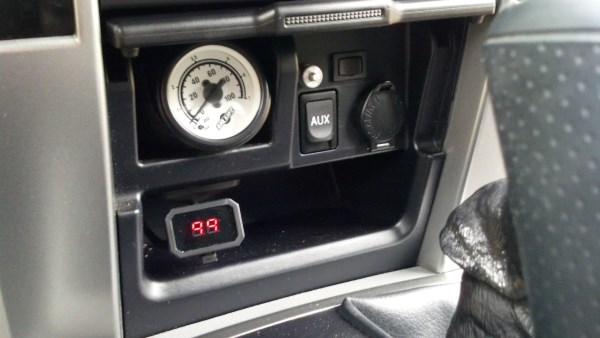

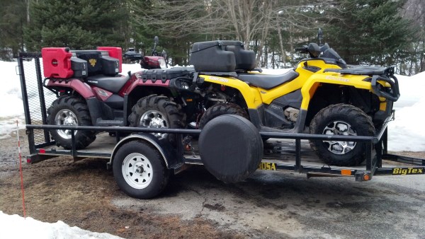

Just wanted to add my 2 cents, G8RB8_12SR5 is spot on with AirLift mod. We pull a 14’ utility trailer with two ATV’s (1,500 lbs) with a fair amount of tongue weight, truck definitely squats when loaded. Addition of airbags (aired up) brought truck back to level. I also added AirLift’s Load Control, basically an onboard compressor, pressure gauge w/bleeder value, and low pressure solenoid. What’s nice about setup is you can add or lower air pressure on the fly. Also, if air pressure drops below 5 psi, low pressure solenoid turns on compressor to inflate back to 5 psi, which is a major cause of airbag failure (under inflation).

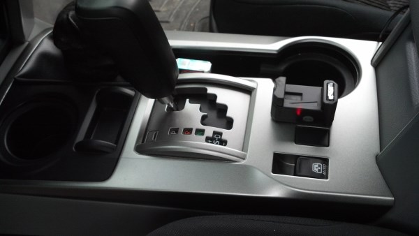

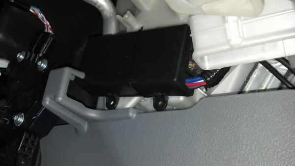

Since my trailer didn’t come equipped with trailer brakes, I added them (truck brakes stop truck, trailer brakes stop trailer), when choosing a brake control, I too didn’t want to drill hole in my dash. Hopkins offers InSIGHT Flex Mount brake control that’s modular. It has three components, Flex-Display, Flex-Control, and Smart-Box. Setup is perfect for those who don’t want to drill holes in their dash panel!
Smart-Box can be mounted anywhere (as long as it’s facing forward), located left front of center console.

Flex-Display fit nicely in lower storage compartment (drilled one hole to run wire, though it’s out of sight). Upper section has air pressure gauge, bleeder valve (just above AUX port), and power switch to the right (to inflate, momentary rocker switch wired to ignition). Cover can still be closed......out of sight, out of mind.
