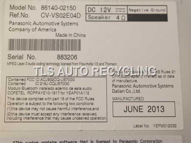

I tried the panasonic model and can't get sound
https://s3-us-west-2.amazonaws.com/...toyota_corolla_2013_radio_audio_165669_05.jpg
This is the unit I installed, with all the same connectors. Everything is working, from Bluetooth, Antenna, Screen/power, etc... but no sound.
I'm guessing it has something to do with the speaker connector/power.
As I understand the antenna (harness) and the speaker/power connectors (OEM harness ); are connected, so there is a possible issue there?
Or I got a broke unit off ebay, despite the guy shipping prompt, packaging well, communicating well, and verifying it functions 100% correct.
Any Ideas???
