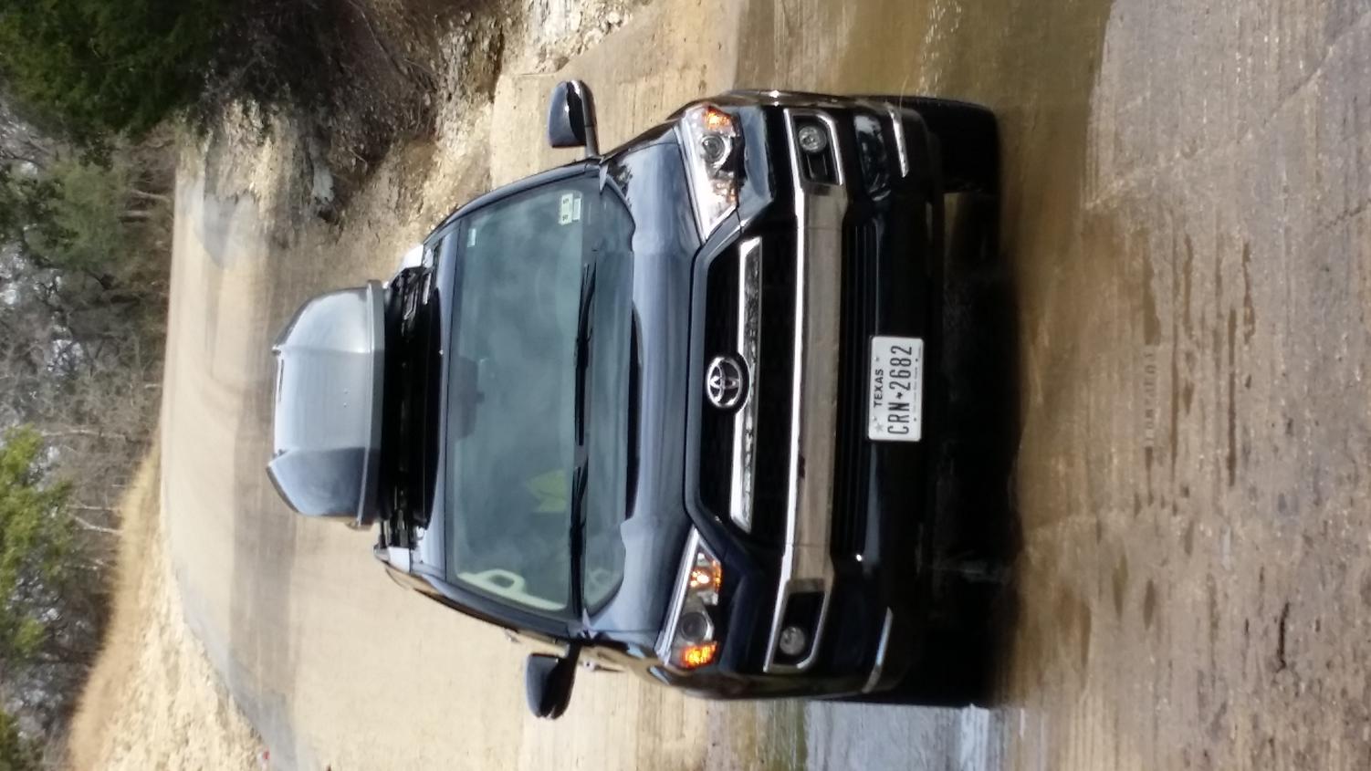

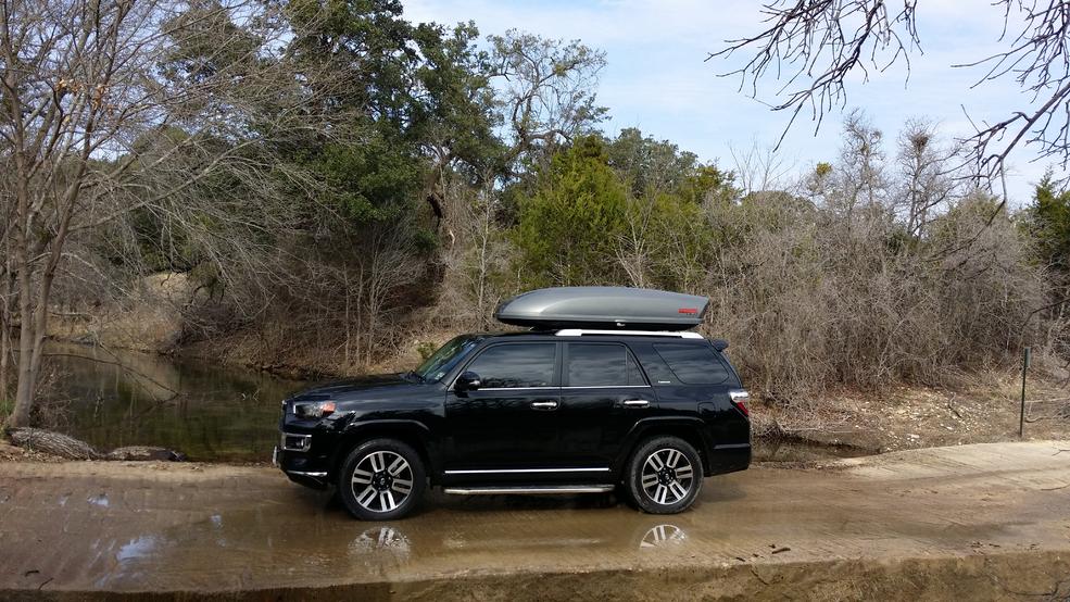

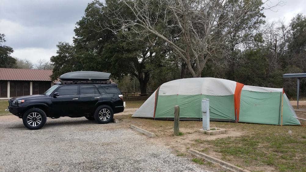

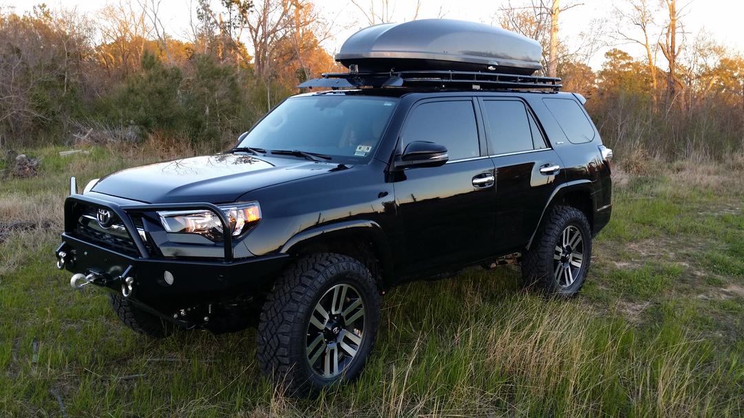

Skybox 21 Pro fits perfectly w/o hitting antenna. I have it pictured here with factory rack and upgraded CamelBak Metal Gear by Drabbits

When you had the Skybox 21 mounted on the factory rack, did you have any issues with clearance for the rear spoiler? Sounds like the 12, 18 and 21 are questionable at best (all the longer option over the 16...)
Most folks say they are mounting their crossbars all the way forward, but did you also slide the box clams all the way back (effectively sliding the box forward as much as possible?) At least from the angle of your photo, it looks like it might have cleared, even if by a 1/4"...
It did barely fit with everything slid ALL the way forward....hope that helps

Certainly does, glad to hear that it didn't hit! Thanks for the clarification.
I had a feeling that even the longer boxes could be pushed forward enough for the rear hatch to open all the way. I've done this on a few other vehicles with rear hatch spoilers and as long as there's no touching, even if its just 1/8" gap... we're good. :thumb3:

I'm calling BS on the Skybox 21 fitting on the factory bars without hitting the spoiler--unless the mounting tracks that the claws slide on are farther back than the 18, which is certainly possible. I had a Skybox 18 on my 2013 SR5 on Friday and it wasn't even close to clearing the spoiler using factory crossbars. It cleared the sharkfin, but barely. It essentially rested on it in the center stiffening channel on the bottom of the box. The 18 and the 21 are the same length. And, yes, I had the crossbars all the way forward.
Thule Sonic XL (2" shorter than Skybox 18 and 21 per manufacturers) and Force XL (8" shorter than Yaks) both clear on factory bars with plenty space on both the the spoiler and the fin. Mounting brackets are farther back. Both these boxes fit skis up to 198cm per Thule, which was my issue.

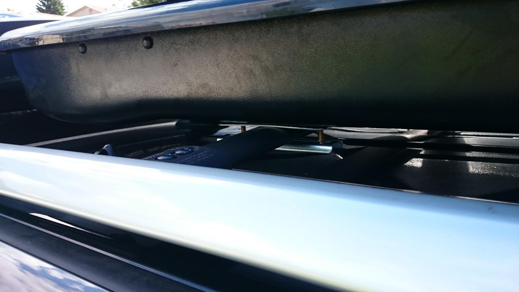

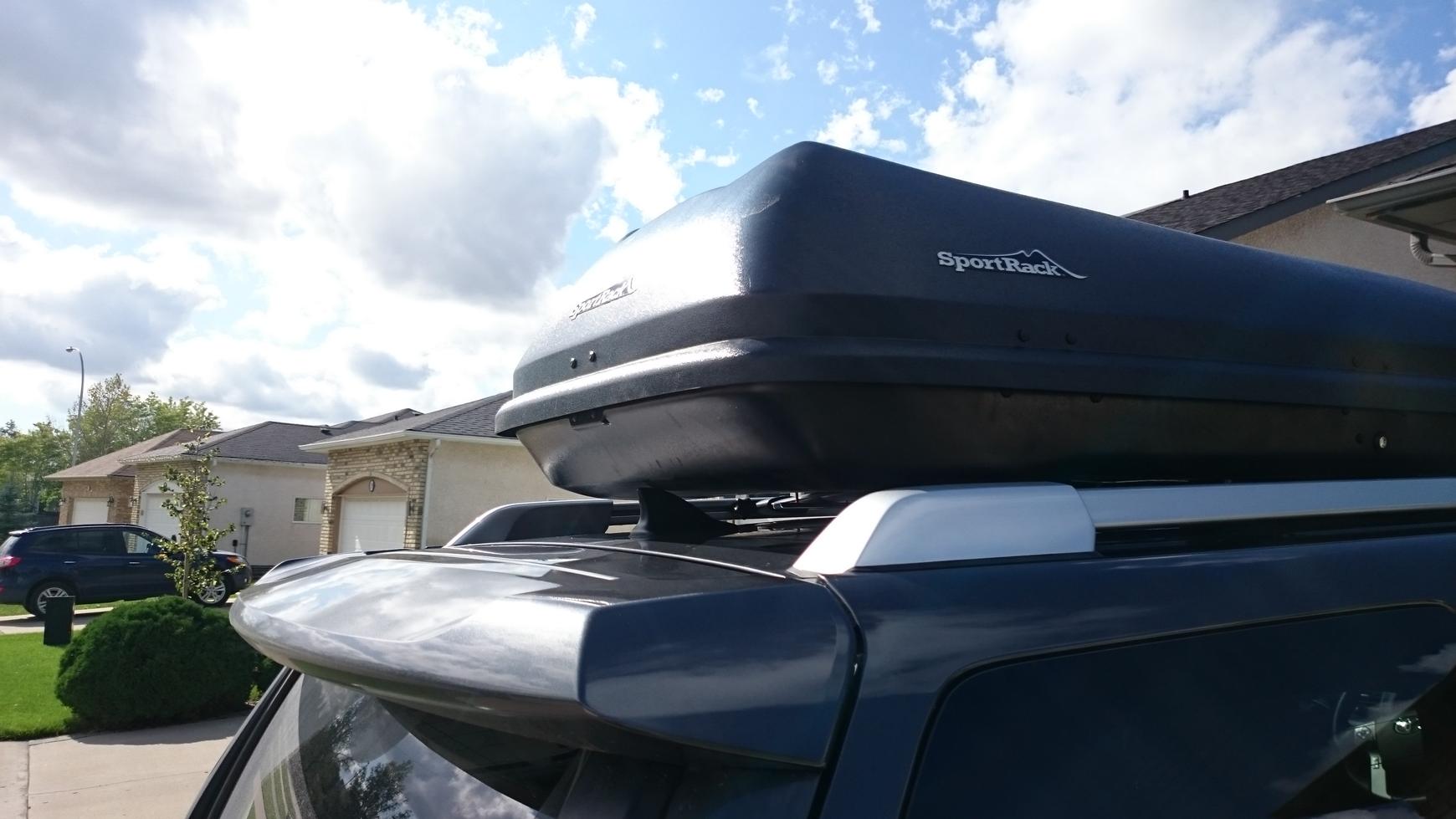

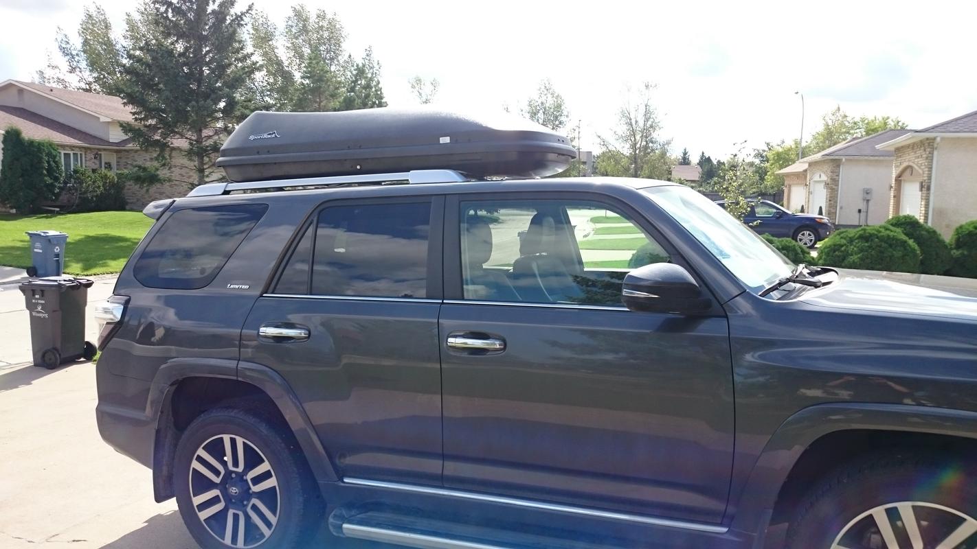

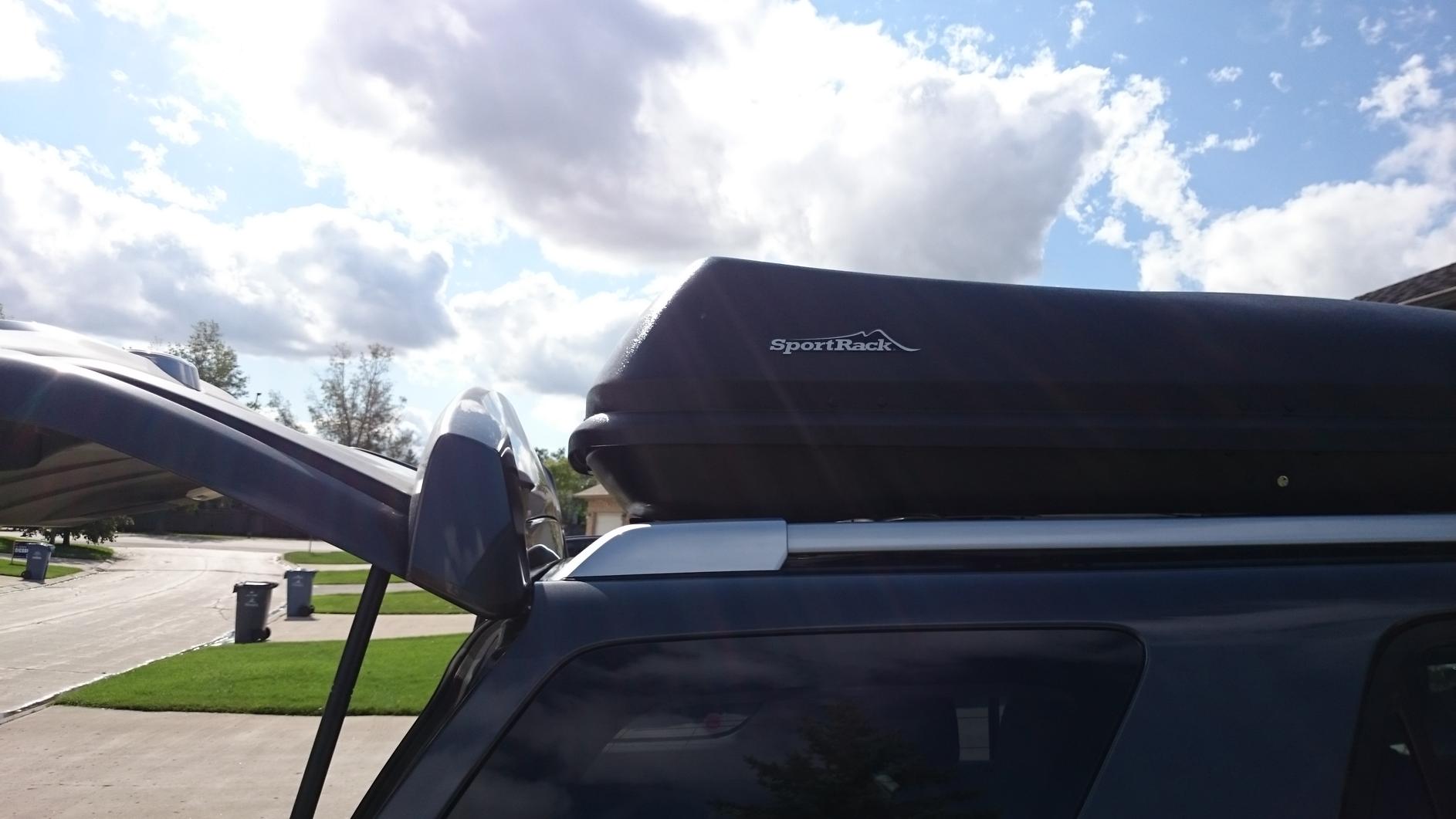

Sorry to revive an old discussion. I have recently purchased a SportRack Expedition roof cargo carrier. Before buying I was trying to find any info on this forum and found none. Hoping this will help someone.
This model I believe is only sold in Canada but is very similar to their Horizon model (of equivalent volume, this one is 16 cubic ft). Installed on 2015 with factory cross bars.
The box fit without any major issues. Clears the antenna (I could have pushed the box forward more from what is shown). I may end up drilling another four holes (one per clamp) and that should give about an inch clearance. Reaching in to tighten down the knobs inside the box may get difficult, depending on ones height a ladder may be required. I managed without it - I am 5'10". The box is not too heavy - generally I would say one man's job to mount.
While driving the wind noise is noticeable - I imagine this applies to any roof box.
I have not traveled with it packed anywhere yet. This is based on a quick install and test drive.

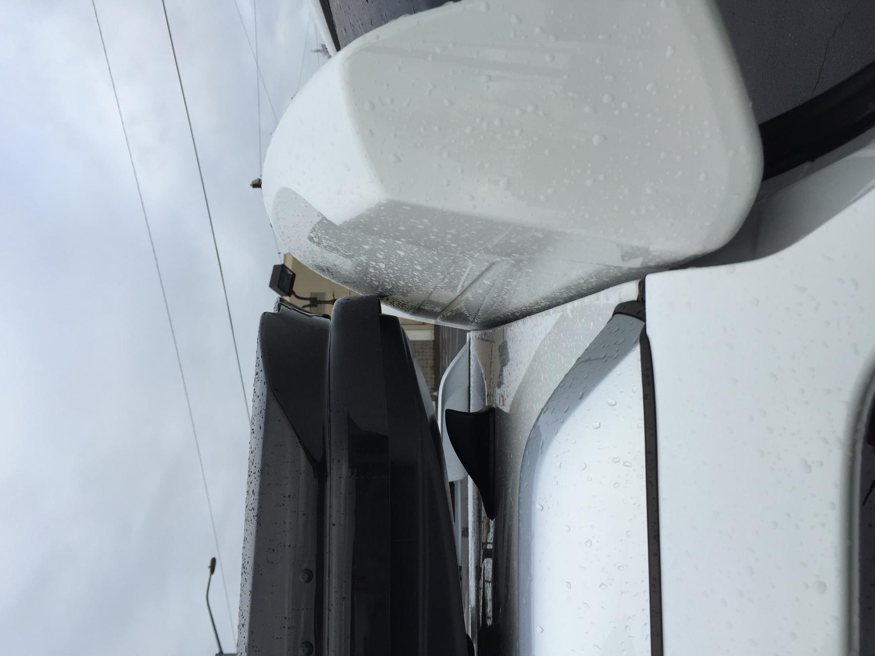

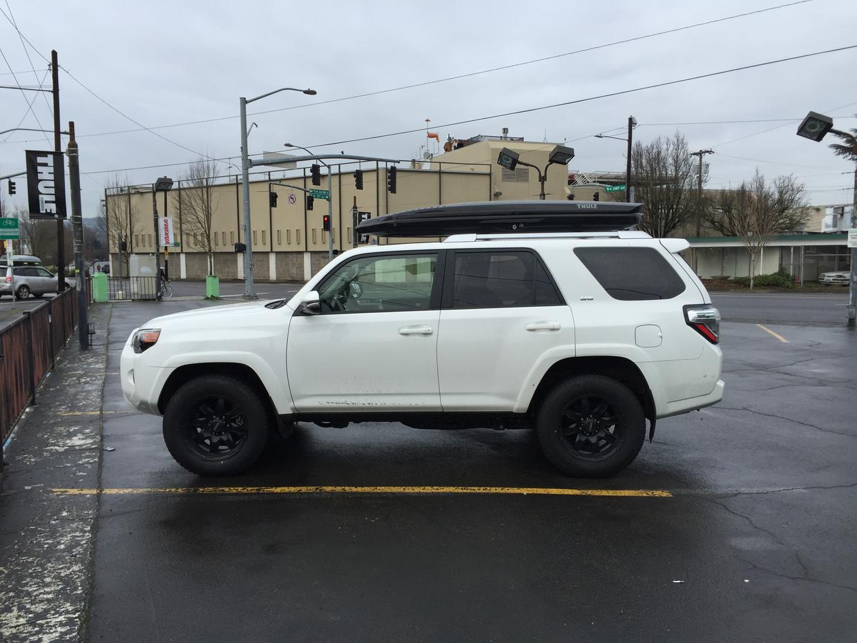

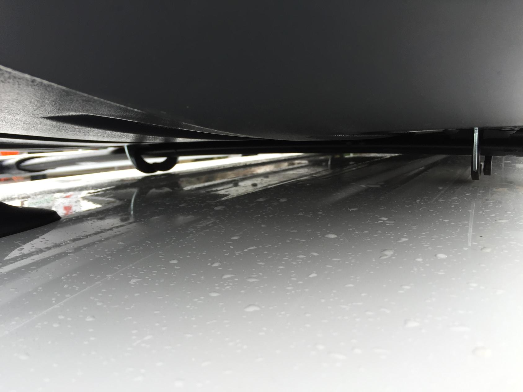

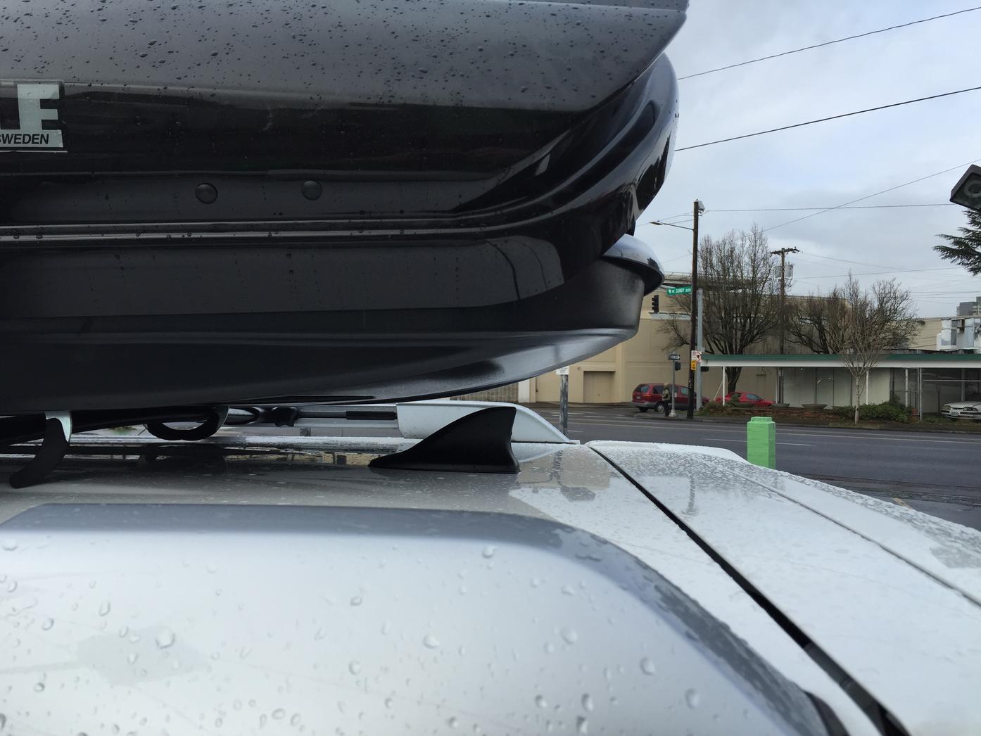

Thule Sonic Alpine
I just went to Re-Rack in Portland, OR and had them test fit the Thule Sonic Alpine on my 2015 4Runner using the FACTORY crossbars. With the bars moved all the way forward the box clears the antenna and is within 1/8th inch of the roof using Thules supplied mounting system. The rear of the box barely touches the hatch when open.
I plan to (1) live with it touching the hatch, as it does not "push" on the box or (2) modify the mounting feet along the slides to get me a couple more inches. How to modify...switch the slide mounts from one side to the other so that the loop/hook is on the front side instead of the back...then cut 'er off..1.5 extra inches (cue sick pun).
The box extends over the sunroof and comes about in line with the windshield. I inquired about that much exposure and was gladly reassured that it should not be a problem.
I am beyond excited as I have been in the search for a box that low profile that will allow me to squeeze into my parking garage at work - which is max height of 7'. I measured with the box on and the total distance from floor to peak of the box is 83" - so 1" to spare.
Hope this helps others searching.

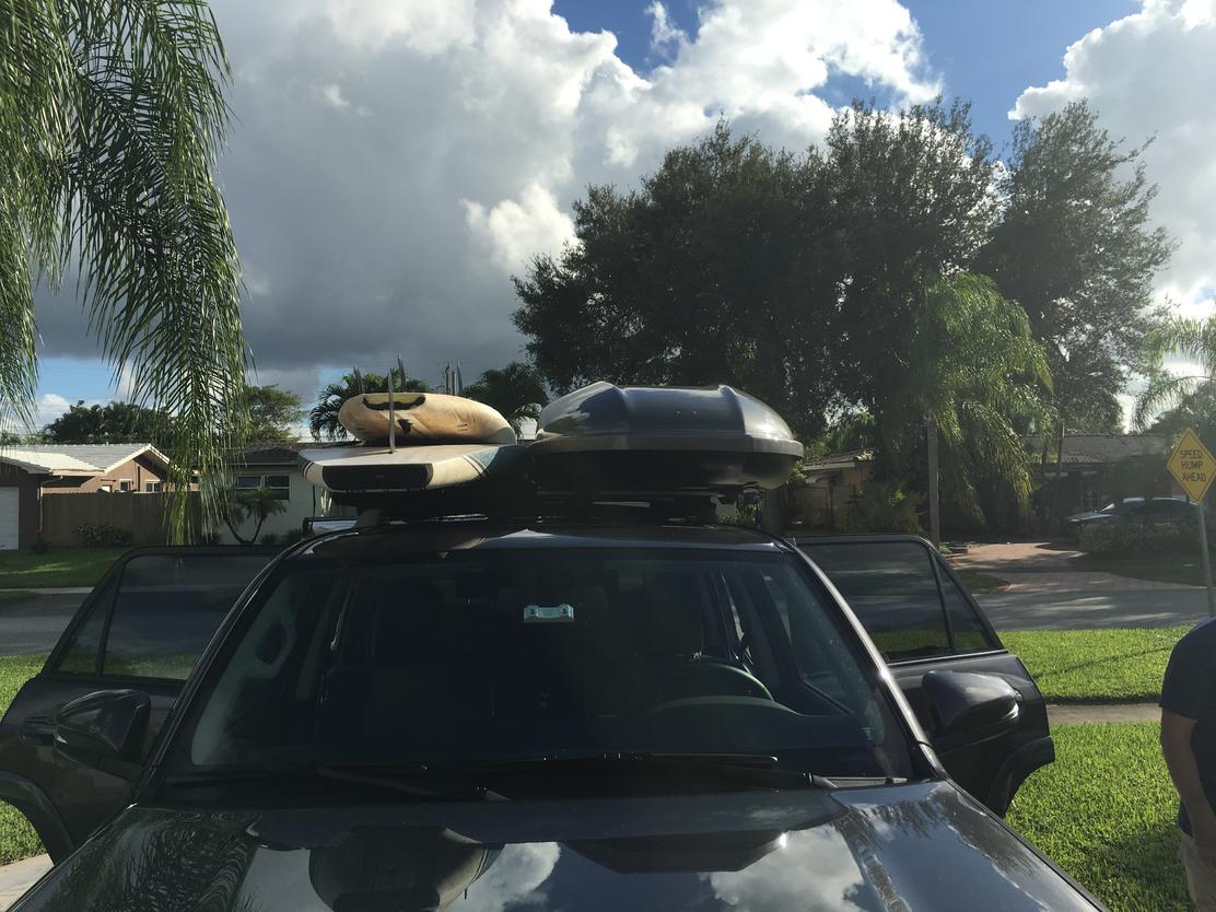

I have the same box but I would highly recommend Thule aerobars, Yakima equivalent or a different full rack. It just allows for everything to be pushed above the shark fin and not interfering with the tailgate. You also don't have to worry about scratching the roof of the vehicle when trying to get the clamps under the factory bars. If you get the 53" bars you can load stuff on the side of the carrier as well. Here is my setup with the Yakima 16 pro skybox, paddle board and longboard. I wouldn't be able to do this with the factory bars.
