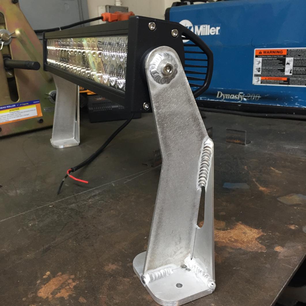

I custom made some behind the grill 20" light bar mounts for 2014-2016 models. I decided to have extra sets cut out, hoping to help out some fellow members that need a quality way to mount a light bar behind the grill. The mounts are 100% water jet cut, tig welded, 6061 aluminum. They bolt directly to the aluminum crossmember behind the lower portion of the bumper by drilling and tapping (4) 1/4-20 holes in the aluminum X-member.
If you need a set shoot me a PM, price is set to recoup the costs of material, water jetting, and weld time. I can assure you won't find a better behind the grill mounting solution for a better price.

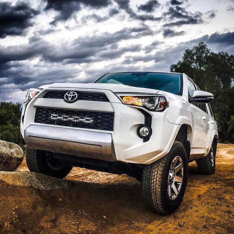

Picture of my light bar mounted with these mounts below.
Here are the mounts tacked up off the truck.

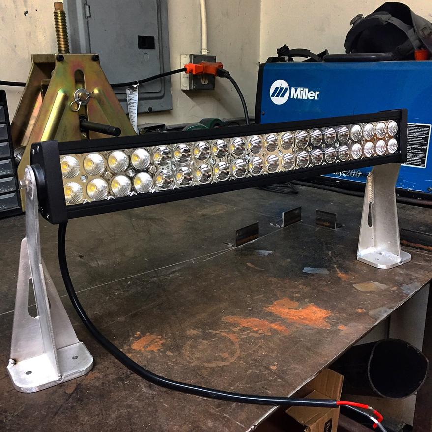

Here's another view of the mounts, tried adding to OP but can't figure out how to add more than one picture a time lol :wtf:
Can this be installed without removing the front bumper? If not, do you have pictures of the light bars installed with the bumper off?
