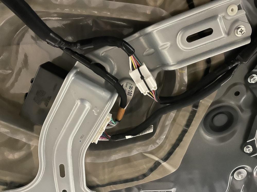

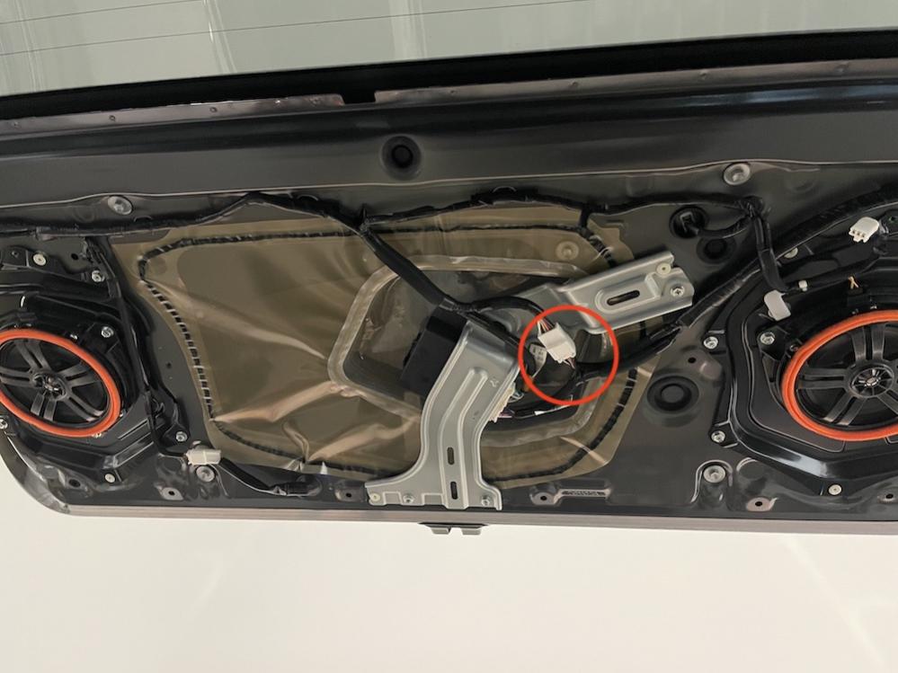

I've had this issue for quite some time but been too lazy to investigate. Finally got around to it. Long story short, I believe there is a plug that has too much tension which forced a connector to be loose in the plug. To fix, I cut tape (relieve tension) and added a zip tie (secured the plug). Been testing this about a week with my tailgate panel off. Steps & pictures below.
1. Remove both rear lights on the panel. I used a plastic pry tool to pop them out. Unclip & remove. You do not need to remove the 10mm bolt behind the lights.
2. Remove the cover from the grab handle. There is a 10mm bolt behind it. Remove the bolt.
3. Use a plastic pry tool to carefully go around the panel and pop off the panel. It should just be plastic clips along the side & bottom.
4. In the center of the door you will see a metal bracket, black box, and a few plugs. Disconnect the harness that is not directly connected the black box (see attached pictures). In my case, a few of those wires were bent and slightly loose. I pressed on them with my fingers just to straighten them out.
5. The plug above is also secured to another harness using tape. Cut that tape. This should allow the harness to not have as much pressure.
6. Plug it back in. To take it a step further, I zip-tied that plug together to ensure a solid connection.
7. Put it all back together.

This is awesome, thanks. My dad's '16 is having this issue. Has it seemed to resolve the intermittent issues? I know you said it's only been a week, but just curious of results so far.
Yes, so far so good. I was originally able to reproduce the issue by opening the hatch and hitting the panel with my fist a few times making it turn on and off. That made me fairly confident that it was not linked to the wires leading from the tailgate to the vehicle nor the switch on the transmission that others had alluded too.
Once I got the panel off and started playing around, moving that connector around also made the screen flicker so I assumed I got lucky and messed with it. Was unable to duplicate after adding the zip tie and relieving the tension on the plug.

My experience was very similar. I highly suggest taking a look at my write-up a few posts back. I have not experienced any problems after implementing that fix.

This post was EXACTLY what I needed to fix the intermittent camera outages on my 2012 Trail Edition.
A couple notes to add:
1. On my year there’s no interior strap/grab handle to remove.
2. Thus, after you pop out the interior hatch lights the entire plastic piece is ready to pry off.
3. There is a triangle arrow mounded in on the passenger side showing where to begin prying.
4. No special trim tool needed. I just used a stiff plastic kitchen utensil.
5. I freed up the tape, straighten out the bend like the OP did. That was enough to correct the issue when I tested. Nevertheless I used 2 zip ties to hold the wire harness straight (it parallels another wire bundle).
No telling if this is a permanent fix or not. Time will tell. However, now I know where this particular gremlin lives and can deal with him accordingly now.

I finally got around to trying this fix on my 2014 Limited and it has been working flawlessly for about 3 weeks now. Thanks to GoHeels for posting this!
Thanks for posting that write-up. I was having an issue where if I slammed the hatch, the camera would go out. It would come back when I opened the hatch, but to get it to stay on I'd have to close the hatch real gingerly.
I didn't notice any unplugged or lose connectors, but I did take the strain off that cable like you mention and everything works fine now. No idea how long that'll last but at least now I know how easy it is to get in there if I need to mess with it again.
