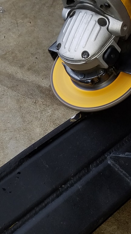

That's the thing with these aftermarket bumpers. You have to bend the AC coolant line to clear contact, vibrations, rattles and all the good stuff that occurs when you modify something. I bent my AC line out of the way and added a piece of rubber hose on mine to minimize any potential rubbing. Did require a little bit of grinding on the bumper to make a notch for extra room for the coolant line.
