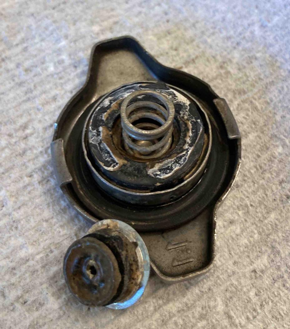

Deceased radiator cap
Forgot to ask for your feedback. Where to start diagnosing? Possible, and probable, outcomes?
Thanks in advance. I LOVE this truck and want her to get the best care she can.
Here is the radiator cap corpse.

So After cooling down - I guess I would start with topping off the coolant and starting her up and see what happens.
It could have been a coolant leak/ loss of pressure, radiator, water pump or head gasket
The clunk you heard is the most concerning thing. If it sounds funny cranking or wont start up, you may have bigger engine failure issues and may need to get it towed to get diagnosed

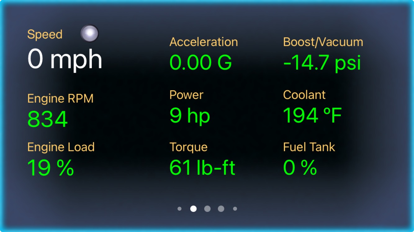

She fired right up, with the code thrown (I'd not cleared it yet). No metal / mechanical failure / marbles sounds at all. None.
Ran the ODBII iPhone app, cleared the code, and turned the truck around so the radiator was high side of the hill. While running, burped and added fluid with the cap off. Left it running.
Then cleared the code. Went for a drive while monitoring temps on the app.
Ambient temp was 89-93.
Windows down, drove for 10 minutes. Coolant temp peaked at 200, then fell down and held steady at 198. Windows up, A/C on full blast while driving. Temp held steady between 194 and 199.
20 minutes of driving, all was well. Sat in the drive way at idle, full blast A/C, temps were perfect.
My best guess is the noise I was hearing was cavitation / steam flash due to a stuck thermostat. Or the combination of stuck thermostat and radiator cap failure?
