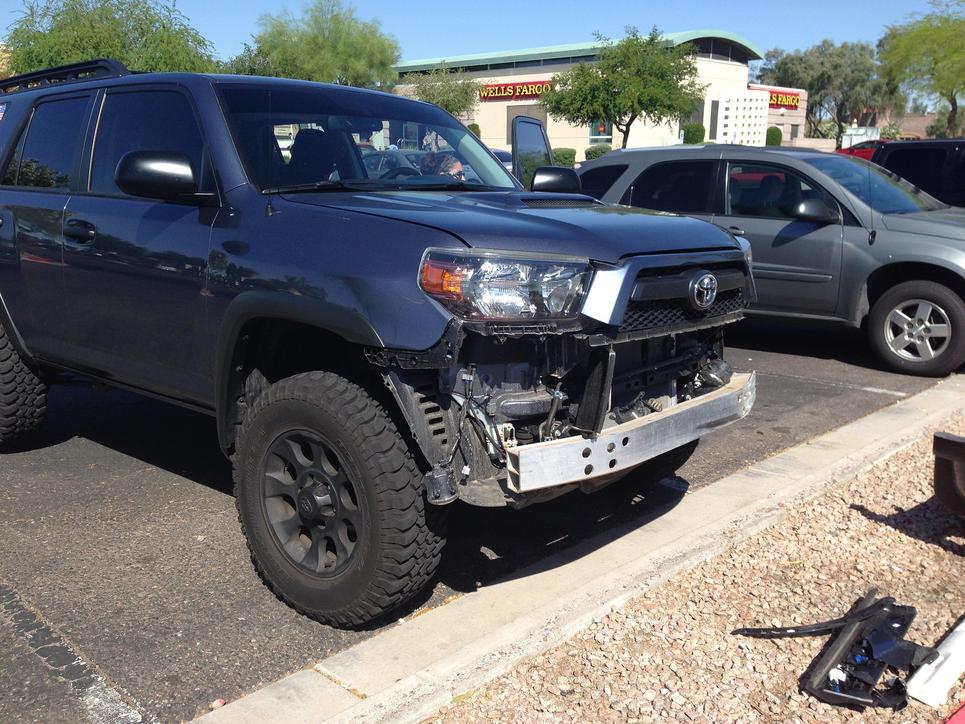

So the wife did the 5 second bumper removal mod in a parking lot (at least she didn't hit something stationary this time), which leads me to my mod of custom steel bumper. Ideally it would be a Schrockworks bumper but I'm not too keen on the idea of leaving the radiator exposed for 4 months so I plan to fab one up myself. After seeing the 2014 Schrockworks Bumper thread and RIDE's comment about the front 2014 headlight conversion, I thought I would explore the option a little more. After searching, I found very little on a front headlight conversion, probably because it could get very pricey. The main reason I'm exploring this option is that the 2014 headlights and upper grille 'end' at the same location in the middle. My plan or my hope is to only convert the top half of the front (AKA the better half).
If this conversion is possible, I know I would probably need a lot of additional parts like the upper grill, probably new upper bumper brackets, parts which I need to replace anyways. I haven't been able to find any online parts diagrams for the 2014 model either. Can anyone point me in a direction of the new diagrams (may just have to go visit the stealership)? I did find the part numbers to the headlights in LED Tail light post.

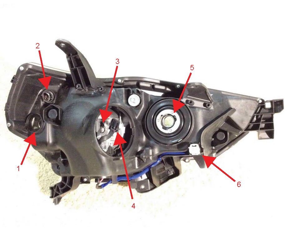

Can any of you 2014 guys or anyone else answer these questions regarding the second picture below (2014 left headlight housing courtesy of somebody on ebay)? My 2013 headlights have 3 bulbs (HI, Low, and side marker) and I know the 2014's have moved the turn signal into the same unit but I can't explain a couple harness' located on the new 2014 housings. Can anybody fill in the blanks so I can explore the front conversion a little more?
From numbers in second photo:
1. I'm guessing this is the relocated Turn Signal location.
2. Side Marker
3. Halogen Projector Bulb location
4. Black Harness = Unknown???
5. High Beam Halogen
6. White Harness w/ blue covered wires and they appear to enter the housing under the projector. = Unknown???
I guess my overall question, are those harness' deal killers? Can they stay unplugged? Something to do with the auto on/off features of the 2014 models. Thanks for reading the long post.

1. Turn Signal
2. Side Marker
3. Hole where H11 bulb goes in.
4. That is the wiring harness they connects to the H11 bulb.
5. High beam/daytime running lights
6. Not sure exactly, but I think that connects the relay harness to the H11 bulb harness inside (#4) , this is not connected to bulb.
I think yours also has the 4 bulbs too. Only difference would be your DRL uses the turn signal bulb and not the high beam bulb.
2. Side Marker
