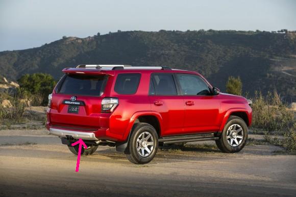

I searched and only found one person that had tried, but was unable to remove the rear silver bumper trim on a 2014. Does anyone know if it is possible? I know there are a couple people on here with 2014s that have already done an aftermarket rear bumper. Just curious if they recall from when they removed the stock bumper.

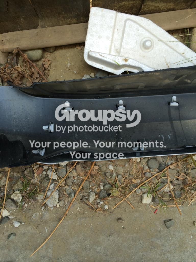

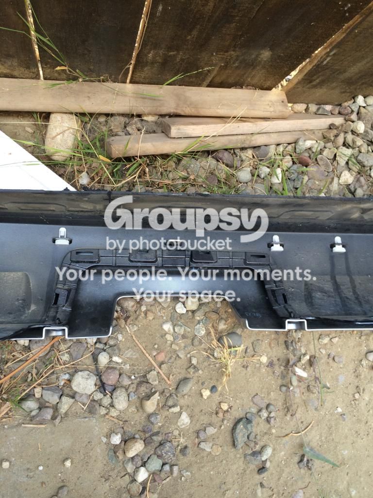

This is what it looks like behind. That's really all I can contribute since the bumper piece was cut off to install my cbi rear.

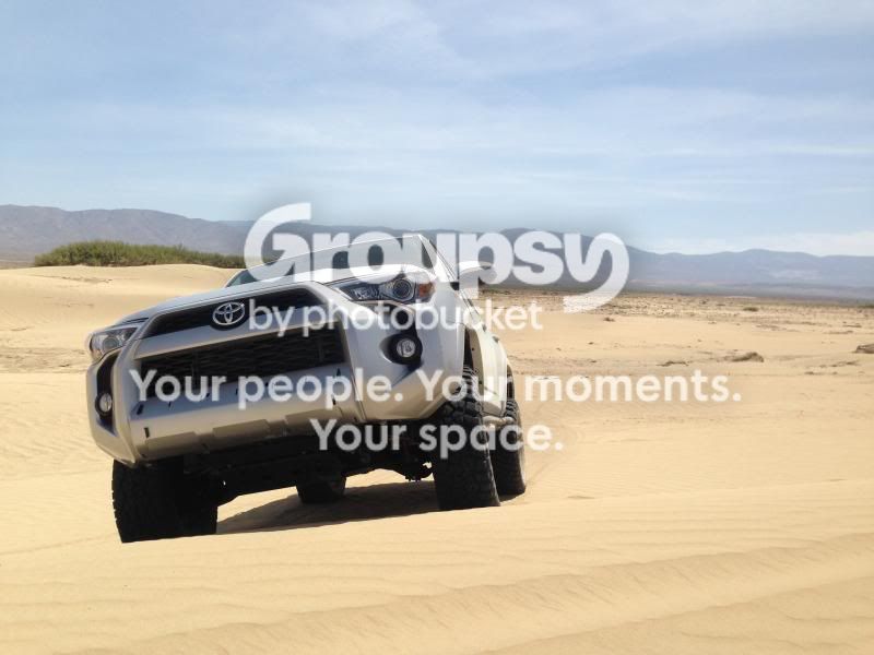

Here is a pic of my front without the trim since a rock ripped it off. You can see the slots and the plastic peices that broke off the trim and are still attached with those white clips.
I can take a pic of the back bumper without it later if you want but I think you'll get the idea.
