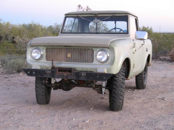

Score some pizza cutters and never hydro plane again :banana: :rockon:
Hey those are slick! Or wait.. I mean, not? Never mind.
Nice Scout, is that an 80? I don't think I've ever seen an 80 on the road.
