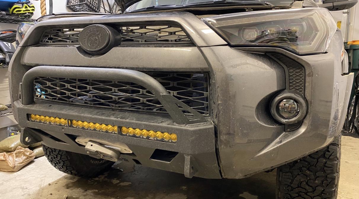

I finally did a thing!
Sorry about the Alaskan winter coating on the car
Got these installed on a 2020 TRD Offroad. Hyperflash from both headlights. Pretty frustrating - I sent Xenon Depot a support ticket mid-November specifically asking if hyperflash would be a problem and would they include a resistor - Mike B responded saying that the resistor on the back of the units had been upgraded and hyperflash wasn't a problem. Seems like a fairly significant issue to either lie about, or just get wrong. Sent a support ticket - hopefully they resolve it.
