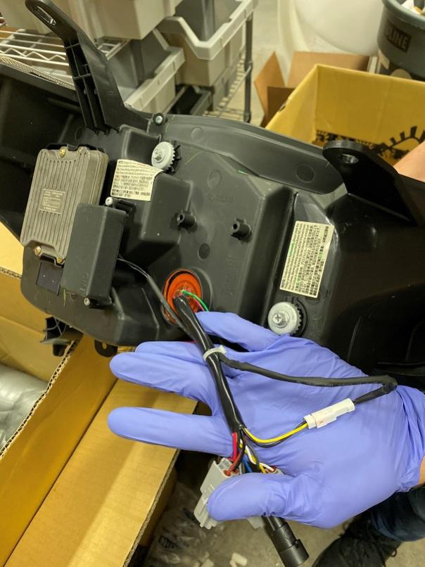

So Xenondepot sent me resistors for my 2020 4Runner. Anyone know where these install? I can’t seem to figure out.

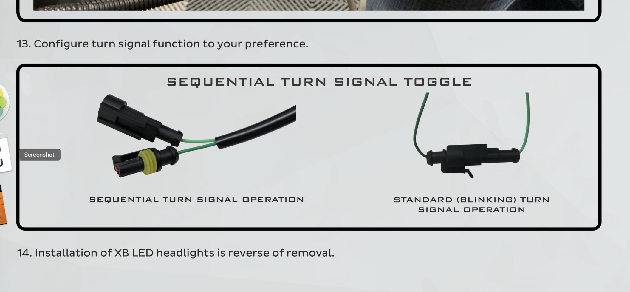

There was a plug during install that said to use it or not. Looked about the size of what you have. Wonder if it's that plug? Guessing its already unplugged if you want the sequential turns, so only one wire????
It wasn’t that connector. I found the existing black box on the back of the headlight and just simply traced the wire coming out of it. Once I found it I popped it off popped the new one on and zip tied the black box so it’s secured. Just tested it and the hyperblink is gone. The picture is just to show you the toggle I unplugged. Sorry for poor lighting.

Awesome. On the backside, you can even see it from up top, you'll want to find the a white connector. Unplug that and plug your new resistor in place of it.
