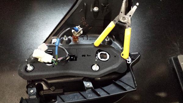

I was surprised to find that the light is not actually leaking, the culprit is the big neoprene seal that is affixed to the back of the light, that do not make firm contact with the body of the vehicle
The location of the leak on the seal is near the upper light bulb, toward the exterior of the vehicle. Water enters there then make its way into the light by the upper light bulb opening. The 2 screws holding the light are located toward the inner side of the vehicle making it prone to leak at this location (less pressure). Droplets were present near the upper bulb opening, and on the wire.

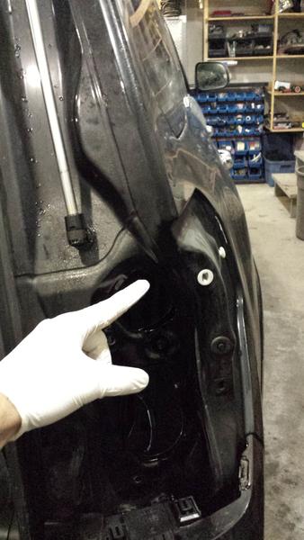

Ok here is a fix I propose. This is what I have done to my lights.
First, the leak was there:
between the 2 yellow handles
You gotta remove the light assembly first, which is pretty easy. Undo the bulbs from their sockets, then, using a 10mm ratchet, with an extension and a deep socket (must have a deep socket, normal socket won't fit, a wrench won't fit too), un-screw the two bolts. With everything disconnected, pull the light assembly ''strongly'' toward you.

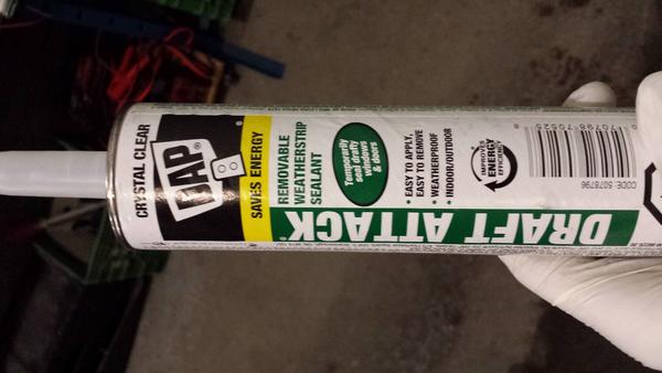

Get some removable weatherstrip sealant like this one

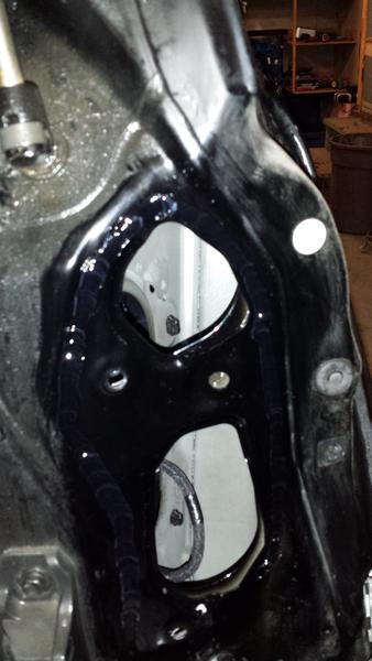

apply to the mating area.
Then re-install the light assembly, taking care not putting it back all the way in by hand (you will damage the silicon bead). Then, using the bolts, screw the light in toward its full seating.

Update on the fix I tried.
Humidity took a few days to evaporate, then no more sign of humidity, condensation or frost, even with colder temps we got. Seems like it's working for the last over two weeks.
